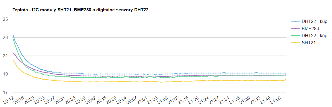

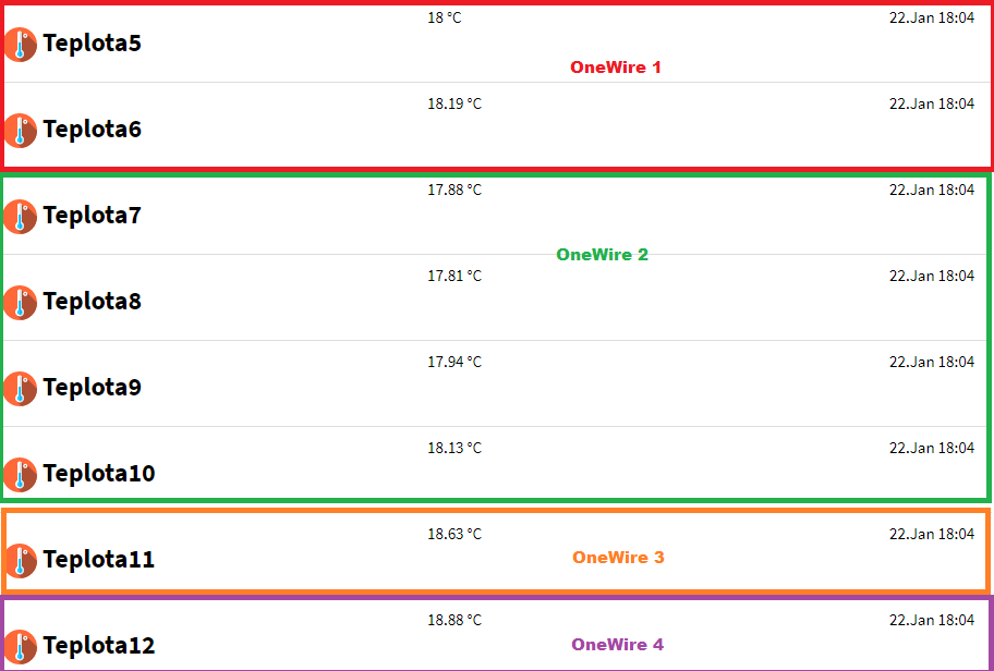

- 8x DS18B20 temperature sensor on OneWire bus - divided into 4 OneWire buses (2,4,1,1)

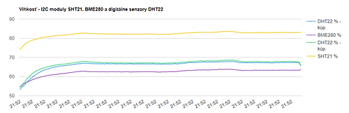

- 2x digital temperature and humidity sensor DHT22 (AM2302)
- 1x temperature and humidity sensor SENSIRION SHT21 (Si7021)
- 1x BOSCH BME280 temperature and humidity (and air pressure) sensor
Sends data from all sensors at once in several minutes (can be modified)
The whole module 1- BYT serves only as a temperature monitor in individual rooms, it has no other role. DHT22 sensors were used over a long distance using a suitable 10kohm pullup resistor to record humidity in the bathrooms. Since the BME280 and SHT21 communicate over the I2C bus and this is considerably limited in terms of bus driver lengths, sensors are used near Arduino in rooms.
The DS18B20 temperature sensors have been divided into 4 buses, as two external sensors are used, making it easier to connect them to separate Arduino outlets and, in the event of a sensor drop, it is easier to replace as it does not paralyze the functionality of the system.
For example, in the case of one of these OneWire buses, on which 4 sensors are indexed. The index is linked to the physical address of the thermometers, so if one of the sensors is exchanged, the new sensor may appear on the index 0 - initial, or even 2, 3 or last. Thus, by reducing the number of sensors on the buses, we can avoid such a complication that can occur when the sensor is replaced.

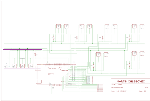

Module 2 - BOILER - hardware:
- Arduino Mega 2560
- Wiznet W5100 Ethernet shield
- 16x DS18B20 temperature sensor on OneWire bus - divided into 7 OneWire buses (2,2,2,2,2,2,4)
- 8x digital input
- 8x digital output - for solenoid / relay
It reads the states of individual outputs from the web interface, applies them
Sends digital input states

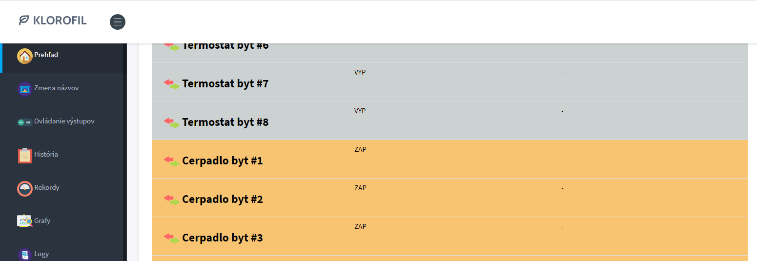

Module 2 - BOILER has, besides the function of the monitor, a more important role, namely the control of solenoids or relays for the control of radiator valves. The module operates independently of domestic heating. Module does not switch heating or boiler. The module only takes care of opening, closing the radiator valve, if the room temperature is lower / higher than the set - so-called. reference temperature.
Each room where the radiator valve is controlled can be assigned a specific thermometer from the module. In addition to this automatic mode, there is also a manual mode where the valve can be opened / closed manually from the web interface indefinitely - hard. The digital inputs can be used to verify that the solenoid / relay / valve has been opened / closed upon request with Arduina - the ability to compare whether the output is equal to the input.
For both modules there is also a graphical representation of a line chart for the development of individual variables - temperature, humidity in 24 hours, 7 days. The web interface also offers viewing of maximum / minimum, average value in 24 hours, 7 days for each thermometer / hygrometer. In module 1, a pair of SHT21 sensors was initially considered, but since they have no possibility of changing the I2C address, it would be necessary to use a multiplexer for one bus communication from two sensors with the same I2C address. In case of faulty sensor data, the sensor name is stored in a log that the system administrator can open at any time to service the OneWire bus and replace the faulty sensor, for example.

Schematics module 1 (BYT):
Schematics module 2 (BOILER):
