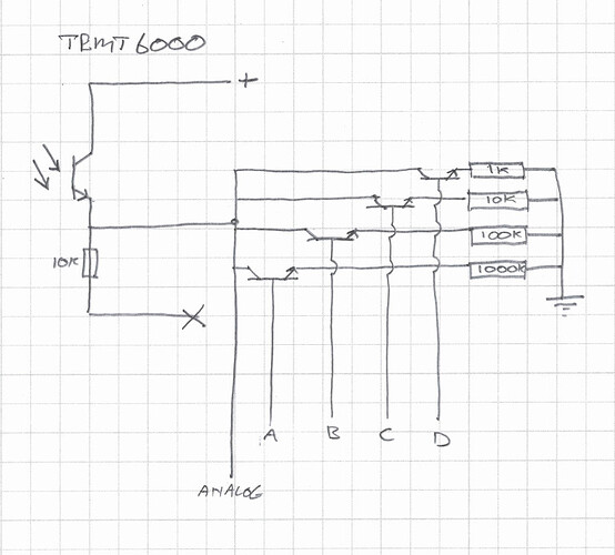

I'm thinking of setting up a system where the resistor can be set by the sketch depending on light levels.
Using 4 output pins I can turn on 4 transistors to engague the resistors. However, would there be a significant resistance accross the transistor?
Would I be better using MOFSETs?
I'm a bit clueless, if I do use MOFSETs, should they be p type or n type?
You can use a 2N7000 or 2N7002 but the circuit needs to be a little diferent.
Thanks a lot Jim.
