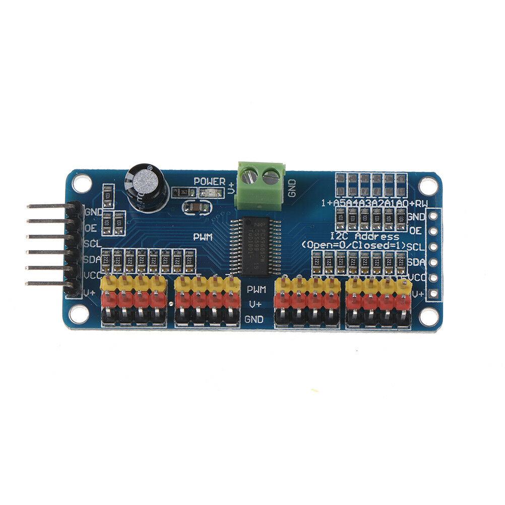

Actually, the description of a lightweight metal shutter strongly suggests the use of servos. Why would you think otherwise?
If you use steppers, you either have to drive them against a stop or have an optical sensor to determine the end position which you need to verify every time your turn them on.
For servos, you use these 16-0utput driver boards:
