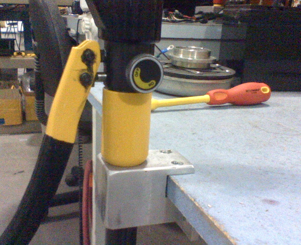

I an attaching a picture of a mounting bracket I made for our tech who makes heavy duty power cables for one of our customers. It was taking three hands to crimp the terminals using the hydraulic crimper.
This way he can do it using only two hands. Might work for you.
Paul
Paul: This device is too large for the Arduino sized headers (and smaller for FPV, R/C, etc...) type micro-connectors. As of now I'm using sticky-tack, tweezers and magnifying lens to wield the terminals. I actually need two or more hands to crimp these terminals, but not the power of both the strength of both arms.
But you understand the concept - gravity naturally pulls the terminal to the floor, so I do not need to do a fun balancing trick with friction to pray the wire won't push the terminal out sideways, or the terminal doesn't twist inside the crimp-die.
