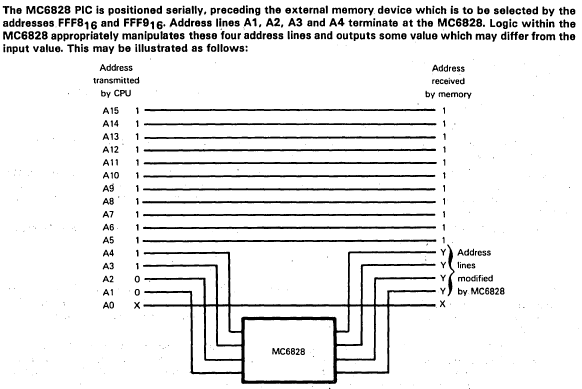

Background
When the MC6800 CPU receives an interrupt signal (IRQ input pulled low) it requests the location of the interrupt service routine at memory locations $FFF8 and $FFF9. The 6828 can change the address requested depending on which of its eight input lines is pulled low.
It does this by sitting on four lines on the 16-bit address bus (A1-A4). During ordinary operation the 6828 passes the A1-A4 bits through to Z1-Z4. When an interrupt pulls one of its eight interrupt lines low the 6828 signals the CPU IRQ line and then sets Z1-Z4 so that execution jumps to an address that is specific to the incoming interrupt.

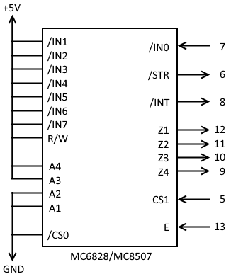

Test Hardware
This high-level schematic illustrates where the 6828 sits in relation to the CPU and the "external memory device" (i.e. ROM).
This abbreviated test harness schematic shows how I've configured the testing hardware. GND and +5V connect to the Uno. The Arduino controls the clock input E, chip select CS1, and IN0 (interrupt zero). It monitors the CPU interrupt INT, Z1-Z4, and the clock stretch output STR.
The 6828 datasheet defines a HIGH output as >= 2.4V (and the INT output is open collector) so pullups are activated on the Arduino input pins. LOW output is 0.5V.
Expected output on Z1-Z4 is b0010.

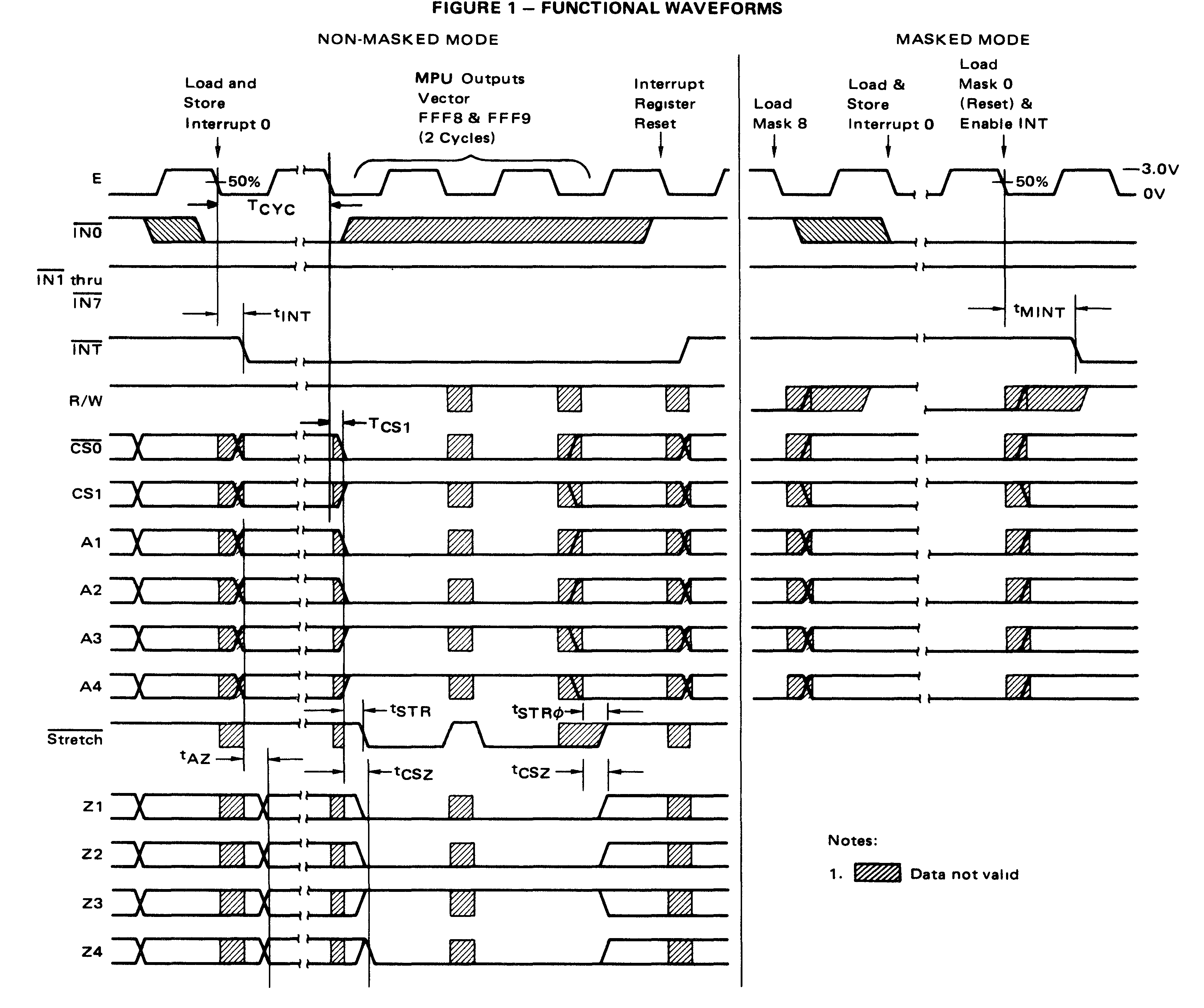

Here is the waveform diagram for the interrupt process (ignore the "Masked Mode section") as well as a functional flowchart (flowchart has an error: it says interrupt vectors go on A1-A4 when they actually go on Z1-Z4).

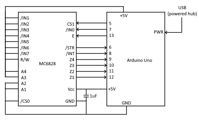

To be frank, I don't see a schematic showing the arduino connected to the 6828, which I would think we need.
Can you draw a schematic showing the arduino and the connections to the 6828 on a blank sheet of printer paper , take a photo, and post it ? I know you listed the arduino pins in the declarations but it's much easier to visualize
with an actual schematic and I don't see one of the arduino connected to the 6828. The hard wired 6828 connections are useful though, for reference anyway.
I don't think the waveform diagram is helping since we don't have a scope to look at. Not sure if the flow chart helps either. Both of those seem to complicate matters. Can we just stick to the arduino connections and code ?
Hi raschemmel, thanks for your response.
My goal with this tester is to verify that the 6828s I received are genuine. To do that I need to verify the outputs and timings. So while there's no IRQ pin on the Arduino I still would like to monitor the 6828 interrupt pin output over time. You're quite correct about the focus of these forums and I apologize about the quantity of 6800-related content. I debated whether or not to include the waveforms & flowchart and decided to err on the side of too much info.
Here's an updated version of the schematic. I hope it's clearer:
There is clearly some sort of electrical incompatibility in play between the NMOS 6828 and the CMOS Arduinio/ATmega328. I've heard of instances in which TTL chips have been powered via their input pins but usually that messes things up. This is the first time I've seen a case in which that caused an ic to function properly.
Here are some possibilities. Maybe there are others?
  1. Use a pin other than 13 for the input clock. I seem to recall reading somewhere that it's not guaranteed to output 5V because it also drives the LED.
  2. Power the 6828 from a dedicated supply instead of using the Arduino's power pins. But make sure to use a common ground!
  3. Buffer the 6828 outputs.
  4. The clock input needs to be at a regular frequency, so use a dedicated frequency source and use it to trigger interrupts on the Arduino to check pin levels.
  5. That blindingly obvious thing that, when understood, will cause me to smack my head and then take a nap.
[Edited for clarity]
