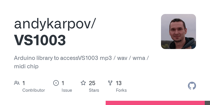

I didn'own such board but I find this library
wich example has an mp3 embedded.
The there is that page also
http://www.electrodragon.com/w/VS1003_(1053)_MP3_Dev._Module
with connectiona and one example but I don't know if the board is the same. The pin names must be identical anyway.
