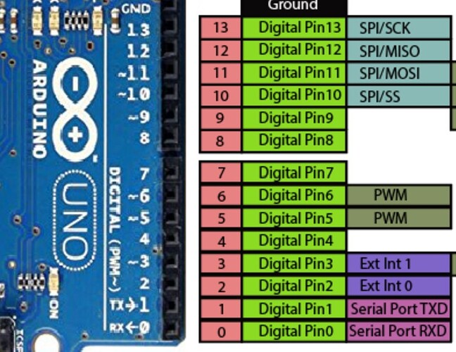

Hey Mike, I simply copy the MOSI & SS pins from UNO and used in MEGA.
Besides i have more devices already using PWM pins. And 3 of TFMini-S already hooked up. Code that i posted here is just for setup 1 TFMini to make sure it works OK. Than COPY logic all over in project.
Thanks.

That is where you are going wrong. Why not use one of those free serial ports? Software serial is a last resort when it comes to communicating.
All those pins on the Mega are first and foremost digital pins, then they have other uses if you want them.

Hi Mike,
I could use them if i choose not to go with some RGB LEDs with PWMs.
I have few PWM bits already used by motors and LEDs.
So, i selected those 51,53 bits for RX&TX while trying to test my code shown above before dumping in my main code. Which is not complete yet. I watched several videos to understand all the hardware 1st and code as i go. I will see if i can switch few bits around to use TFMini.
