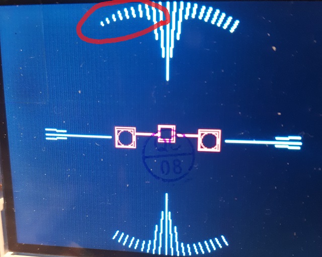

Hello. I have my esp32 and ili9341 up and running. I'm not a coder but more of a
play with it till it breaks kind of person :wink:
I'm trying to draw a 'HUD' on my display. It's a 320x240 display set to landscape.
I have it very close to what I want but am having difficulty with one piece of code...
     //SMALLEST_TOP bars_left
     // Draw tick -12th degree
  for (int i = 330; i < 350; i += 3)
  // Coodinates of tick to draw
    float sx4 = cos((i - 90) * 0.0174532925);
    float sy4 = sin((i - 90) * 0.0174532925);
    uint16_t x0 = sx4 * 120 + 160;
    uint16_t y0 = sy4 * 120 + 120;
    uint16_t x1 = sx4 * 110 + 160;          //110 should increment by '1' each time.
    uint16_t y1 = sy4 * 110 + 120;          // higher number '110' will make the tick shorter.
    // Draw tick
    tft.drawLine(x0, y0, x1, y1, TFT_BLUE);
This code draws 7 lines 3 degrees apart but I'd like them to get smaller by '1' each time
a new line is drawn.
I've tried adding another for loop but the results have been...not what I want lol
Thank you.
I'll try asking this in programing section.
Thanks

OK I figured it out. Was quite simple :blush:
  //for (int j = 1; j < 7; j++)  {
  int j = 2;
    uint16_t x1 = sx4 * (120 - j++) + 160;          //120 should increment by 1 or 2
    uint16_t y1 = sy4 * (120 - j) + 120;              // 120 here should be the same as above
    // Draw tick
    tft.drawLine(x0, y0, x1, y1, HUD_colour);
I have circled the code.
