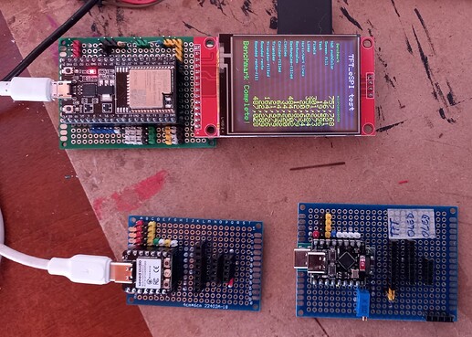

I usually make some test PCB's for general testing new HW or new sketches. on the foto you see an ESP32 WROOM 38pin Dev Board, an XIAO Esp32 C3 Mini board and a ESP32 C3 Supermini board which I allready used many times.
