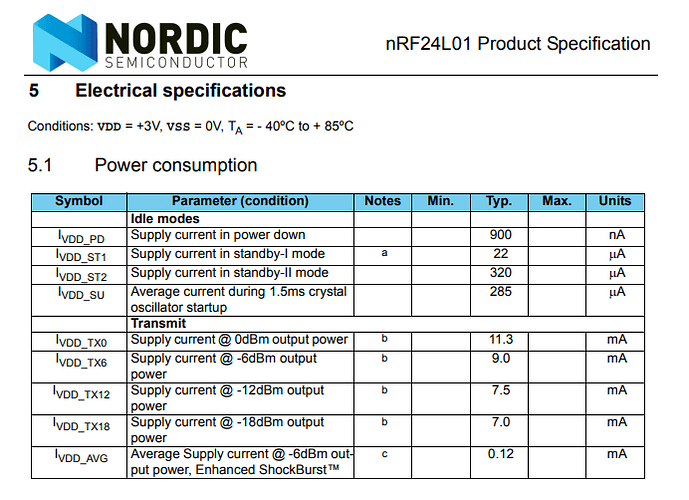

I am creating a device based on a ATtiny85 MCU that will be powered by a coin cel battery that I wish to last for many months. The work the device is expected to do is to wake up when a pot value changes, transmit (by nRF24l01) the analog value sensed from the pot, and then go back to sleep.
The schematic I have in mind (below) has a pot (RP1) with a pin at ground, middle pin as sweeper to the ATtiny, and the final pin at VCC, basically a 10kohm battery leak. I can raise the value of the pot to make it drain the battery slower, but the higher the impedance the more it will be effected by RFI/EMI causing false triggering, waking the radio, etc... killing the battery.
Is there some sort of extremely low powered comparator I can use to wake the MCU? Or perhaps ditch the ATtiny for an MCU with more pins so I can use the internal comparator (that is, of course, if "wake on internal comparator" is such a thing ).

I am not sure the CR2023 will be able to provide the pulse energy for the NRF when it transmits.
Have you measured the idle current of the NRF.

With proper usage the nRF will consume negligible current compared to the MCU.
And the current spike for transmitting is easily covered by a capacitor.
And to reduce current consumtion of the pot connect it to MOSI instead of Vcc.

“I am not sure the CR2023 will be able to provide the pulse energy for the NRF when it transmits.”
My transmit distance is 2 meters, the nRF24l01 at -18dBm will draw about 7ma. I sourced this information from Table 5.1 of the nRF24l01 datasheet (see chrisnightly’s embed above). Is there another power domain element that I have overlooked?
