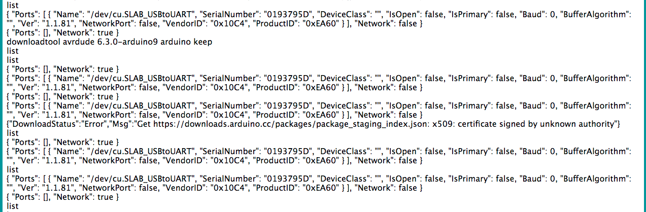

Sorry to come back to this ageing thread, I got this error on a completely unrelated-to-Arduino website the other day:
It's a popup window in Safari browser on MacOS. I think it's a javascript error or something similar.
I think the OP must be using the online web editor IDE and it's being a bit temperamental.
For whatever it is worth, I just got the same error message using the Arduino Create cloud IDE.
The code compiles fine on the cloud IDE and will upload from the desktop IDE, but it fails with the [object Object] error during upload on the cloud IDE. The cloud IDE does recognize that the board is plugged in.
The debug console shows a different error message (during upload) about a package certificate being signed by an unknown authority. I have added a screenshot.
Here's an explanation of the cause of the error and a workaround from someone who experienced it:
http://forum.arduino.cc/index.php?topic=590962.msg4023404#msg4023404
This is also relevant:
http://forum.arduino.cc/index.php?topic=590962.msg4036725#msg4036725
