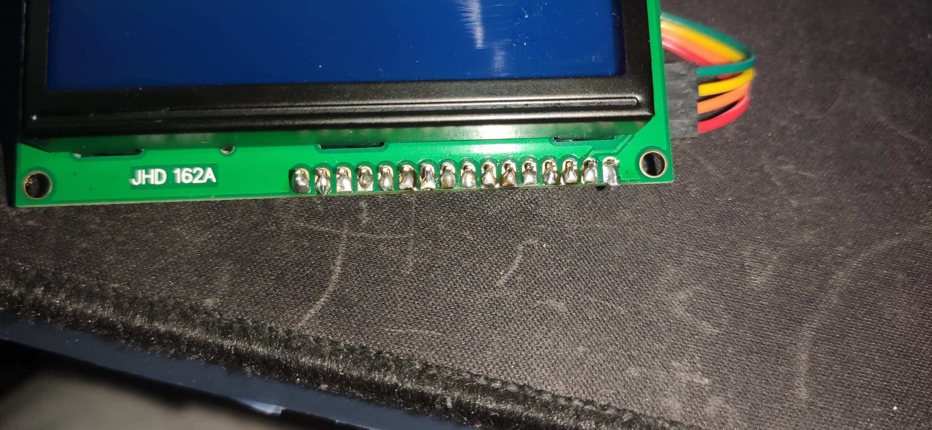

The LCD only displays a line of blocks
Please help my LCD only display blocks (connected with I2C module)
I'm pasting the I2CexpDiag of my LCD Display using hd44780 library.

From the diagnostic report:
Is the backpack professionally soldered ?
Please post a photo if the soldering was done by you.
Adding to @ david_prentice... my BREADBOARD has caused me errors (LEDs not lighting, shift registers doing random, OLEDs not displaying... and more... so check your breadboard, too.
I soldered it myself
If you see black blocks on the display, it is powered up, but communications are not working.
Haven't used a breadboard, directly connected it to the arduino.
grafik
check and resolder all connection points
Apply your soldering iron to each terminal in turn. The solder will flow nicely and give you a shiny joint that wets the pin. Just like the professionals.
Everyone had to make their first soldering. Practice makes perfect !!

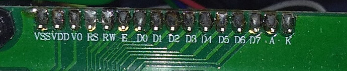

Do these boards have vias to ensure one-side soldering becomes multi-layer continuity?
Typical 16x2 LCD have double sided pcb. There are hundreds of vias.
Typical backpacks have double sided pcb. You can see one or two vias.
The ordinary mortal buys an LCD with ready-soldered backpack.
The enthusiast buys separate items. And solders the terminal rows together with some male header strip.

I think this (double layer, without a via connecting the layers) is a possible cause for lack of continuity, or the need to solder both top AND bottom layer to their respective solder pads. A via would only need soldering on the top OR bottom layer to complete continuity. This means, if a header is soldered to the obverse side of a board without vias, the pads on reverse side of the board will be covered by the plastic of the header, not allowing soldering on that side, resulting in open pins. Just a thought.

Indeed. Pin 5 is not connected and given that it is the Read/~Write pin, that is critical for proper operation, while pins 4 and 6 may or may not be connected as well.

I don't see what the fuss is about. Chinese pcbs are well made and well assembled. I doubt if you will ever get problems with the pcb on either LCD or backpack.
The 16 "user" terminals are plated through.
This makes them mechanically strong and electrically reliable. The gold surface making them easy to solder.
The photo in #5 / #8 shows poor soldering. Just re-make the joints with a soldering iron.
Yes, you do get some pcbs with the occasional single sided gold test pad.
These are not intended for "users". Soldering wires to them is mechanically fragile.
