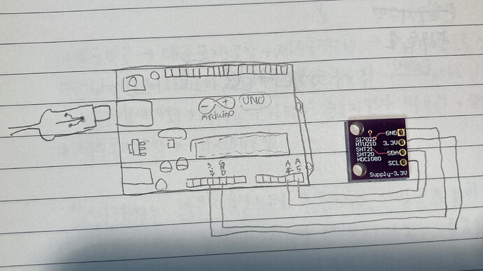

How could I measure the temperature by arduino uno, hdc1080, and breadboard? I want to know the code. I asked chatgpt that question, but I can't solve the problem. help me please!
I think I can measure the temperature, but I can't. the temperature is measured by 125 degree again & again.

I used this code,
and I used this circuit.

Also post a schematic (even freehand) of your project.
Provide a link or the datasheet of the components used in your project.

do you get anything printed out from this?
