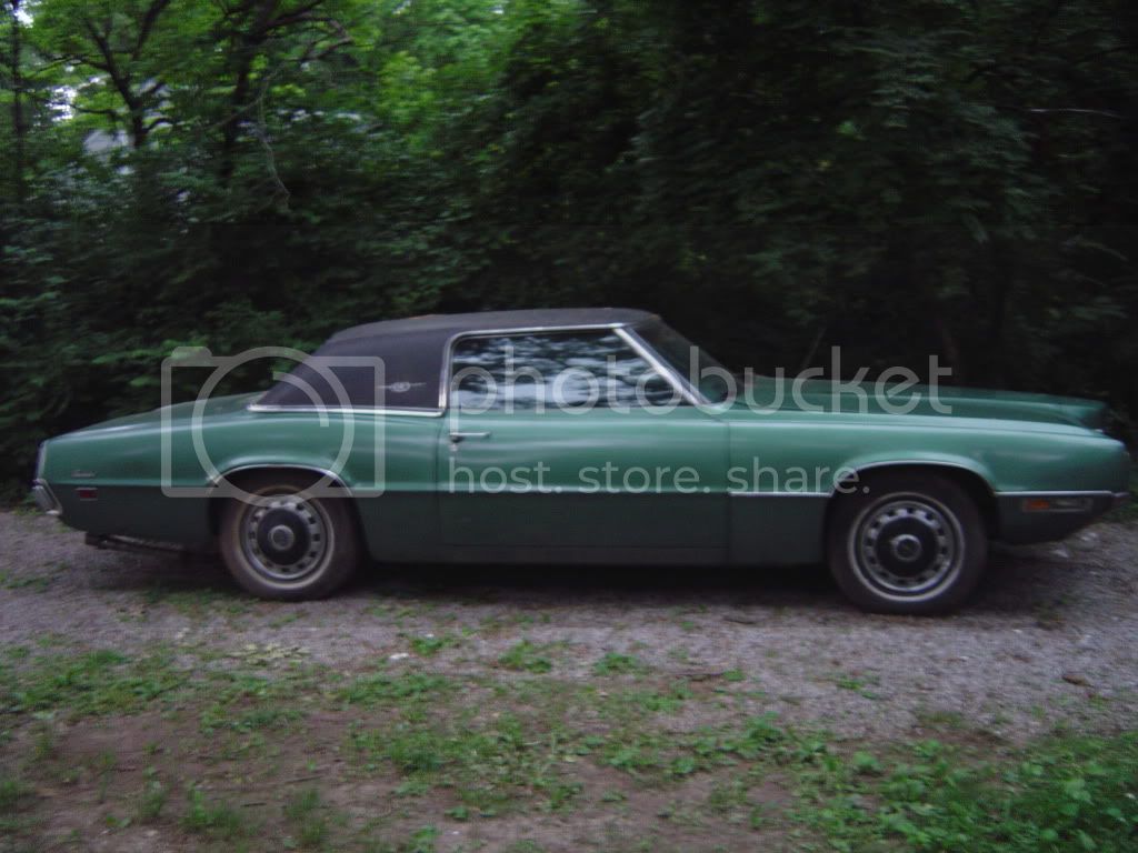

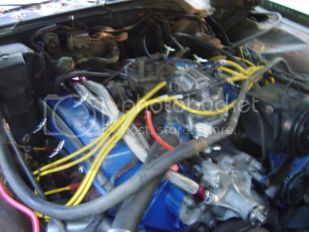

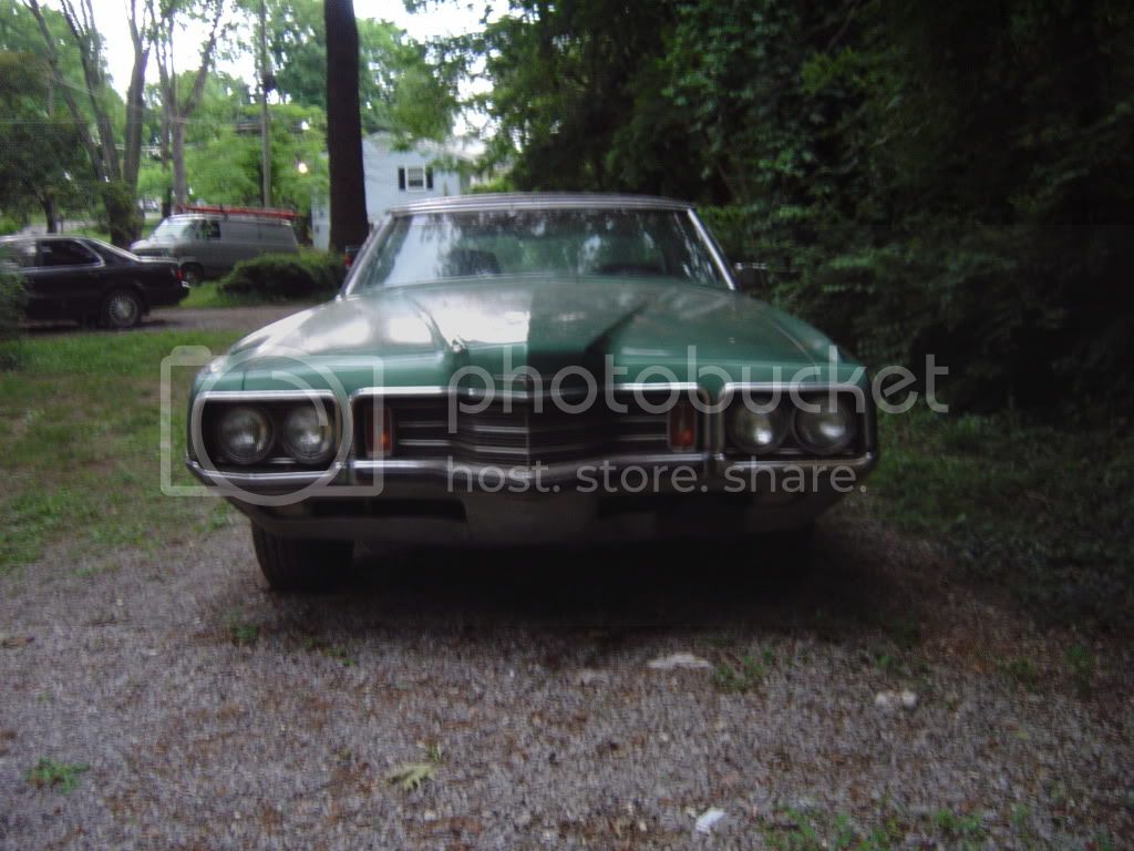

This is a 71 Tbird I bought when I was 16, drove for a few months, realized that 500ftlb is cool, but 6mpg is not and just kind of parked it for 12 years. Recently I pulled it from the garage and got it running again.
Even though the TBird was a luxury automobile ( cost over twice what a mustang cost) I bought it because it represents everything that is crazy about the USA way of thinking. Its a 21 foot long COUPE with every option available in 71. Power Seats, Power Windows, Locks, Vacuum activated windshield wipers and washers. It weighs over 5,000lb. Did I mention the 429CI engine? ![]()
I am wondering if it would be possible to use an arduino (maybe a pair) or an arduinomega to run EFI on this car. Currently there is VERY LITTLE available in aftermarket EFI systems for Big Block Fords. There are all kinds of systems for small block ford/chevy and even big block chevy, but big block ford, Nope.
Ford equipped some mid 80s F-250s with EFI 460s. (A 460 is the same as a 429 but with a longer stroke. The 429 can rev much higher) I had originally planned to one day acquire all necessary parts from one of these trucks, and burn a custom eprom for the Ford EEC-IV it would then be equipped with, but I hate EEC-IV.
At first consideration, using arduino for EFI seems impossible, but MOST of what is necessary is actually sitting right there. This car is grandfathered from emissions testing, so it wouldnt have to run perfectly. Id just like it to run on cold days without having to mess with the choke first, and hopefully increase MPG by around 2-4, which would be easy enough to do with a custom ROM map. The vacuum secondary carb that is on there right now is great for idle, but under WOT it goes super rich as most carb'd cars do, so an extra 2-4mpg is very attainable.
