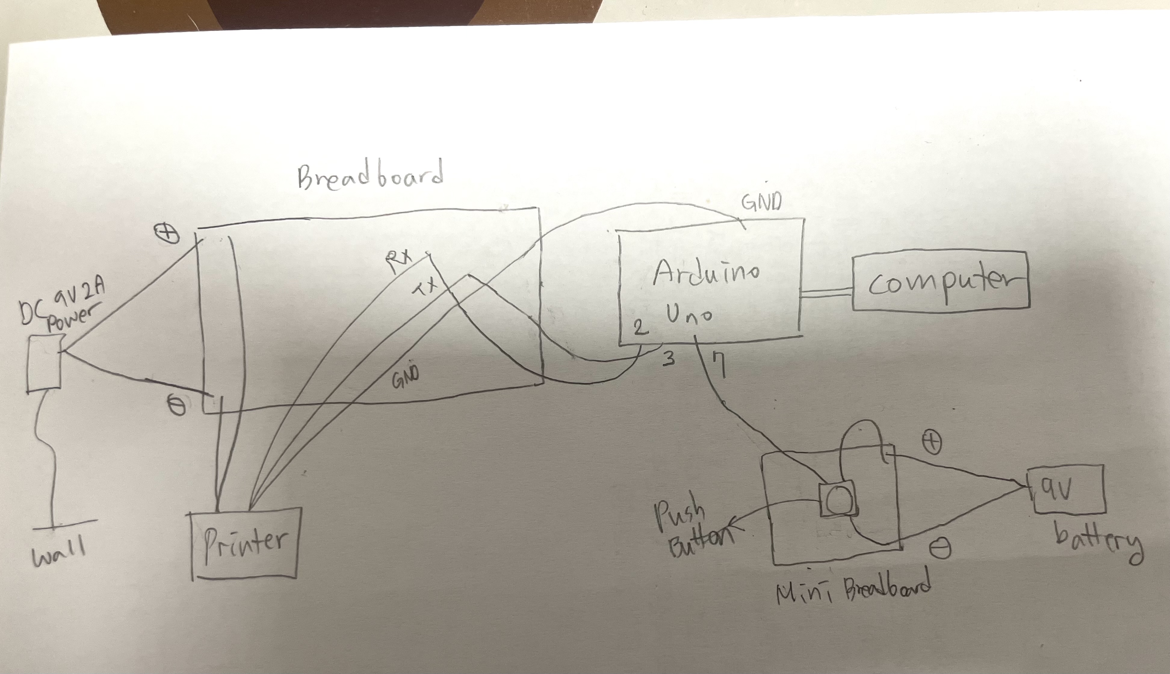

And now I'm trying to make it work when the button is pushed, but it doesn't work.
I cannot find the reason so writing this for help.
Below is the code I failed.

And this is the circuit.

There should be 2 wires coming from your "mini breadboard" - one to pin 7 and the other the the UNO GND.
What is the purpose of the 9V battery attached to the mini breadboard? Is it an illuminated pushbutton?
You should be able to connect the pushbutton between UNO Pin 7 and UNO GND.
Look at the Arduino File/Example/02.Digital/Button example, and consider putting much of the stuff in your setup() function into a printLineOnTheThermalPrinter() function per
You might modify the Button example to also call a printLineOnTheThermalPrinter() function ehrn the button is pressed.
OMG it works!!!!! I still can't believe this goes well... :face_with_open_eyes_and_hand_over_mouth:
You saved my time, energy, .. and other things!!! Thanks a lot!!!
I'Il do my best to give a lot to beginners like me in the future. Super thanks!
Since it works, now I'm going to make it sophisticated by your suggestion and the link. Thank you so much!
Thanks to you and the kind instruction attached, I revised my code and it is now much easier to read and apply. Huge thanks from the bottom of my heart! Have a nice day :grin:
