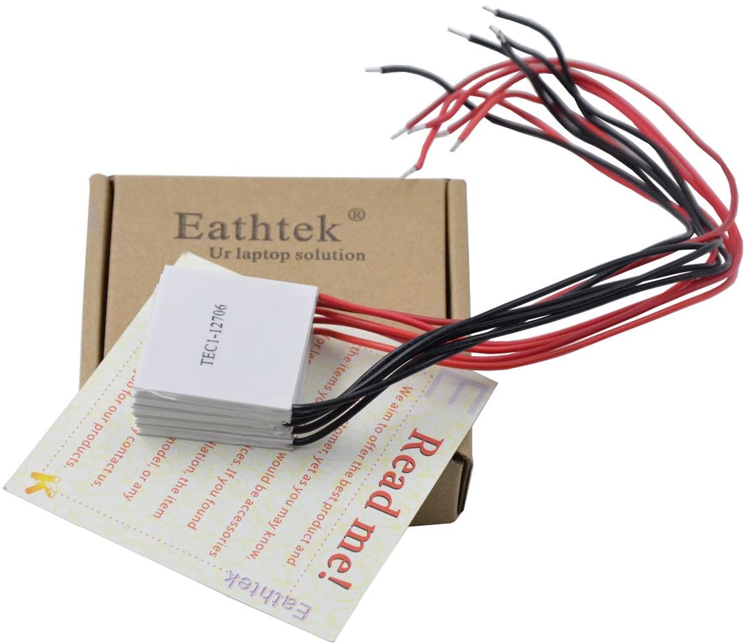

Thermoelectric Cooling+Heating Blanket
I want to build a blanket or mattress pad that heats the head and feet areas and cools the rest of the body.
I want to achieve this with thermoelectrics: these are solid state components that use electric power to pump heat. One side becomes cold and the other side becomes hot.
Here are some thermoelectric components I ordered from Amazon:
I imagine that such a device would probably need three materials:
  • A thermal conductor to distribute the temperature treatment throughout the blanket or pad. Ideally, I could find a fabric-like or at least flexible thermal conductor with reasonable conduction speed and efficiency.
  • A thermal insulator to keep the hot and cold areas separate.
  • A surface fabric to protect the user from extreme temperatures, but still allow the temperature treatment through. This should probably be in between the insulator and the conductor material.
Any ideas or suggestions on these? I feel like the basic premise is viable, I'm serious about putting effort into this, but I suspect some feedback from more experienced people would be extremely helpful at this stage.

To get low temperatures, the peltier is used, or with pressure/vacuum like in a refrigerator, or by vaporating liquids.
You have a peltier, mostly called 'TEC'. Those are not flexible and require a lot of current, and a heatsink on both sides.
The main problem is to get the cold and heat away from the TEC and distribute it.
That would need perhaps copper plates of at least 1 or 2 mm thick. I think you can never ever do that with a fabric.
If you want it to be flexible, you need a liquid to get the heat and cold from the TEC.
I suggest to buy a number of those TECs and test them.
They are only 2.50 dollars (inclusive shipping)
When you power them, you see how much power they need, and how easy they overheat on the hot side.
When you have about 10 of them, you would need 10A or 100A. So you also need a big power supply.
I suggest to look at other options.
You could use warm and cool air and pump that into perforated tubes. That way, there are no electrical wires on the mattress which is safer.
You could use a unit under the bed that uses TEC modules with heat sinks to create both hot and cold air.
Instead of air you could use a fluid, and have that pumped around. With two closed circuits (one for the hot fluid and one for the cold fluid), the TEC modules can make it hotter and colder everytime the fluid passes the unit under the bed. But one day, it will start leaking. The leaking doesn't have to be very bad, the fluid is not pressurized and also some cold and hot packs have safe fluids (some are more gel-like).
