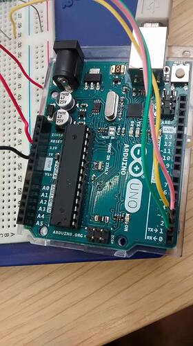

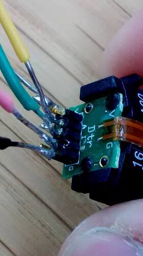

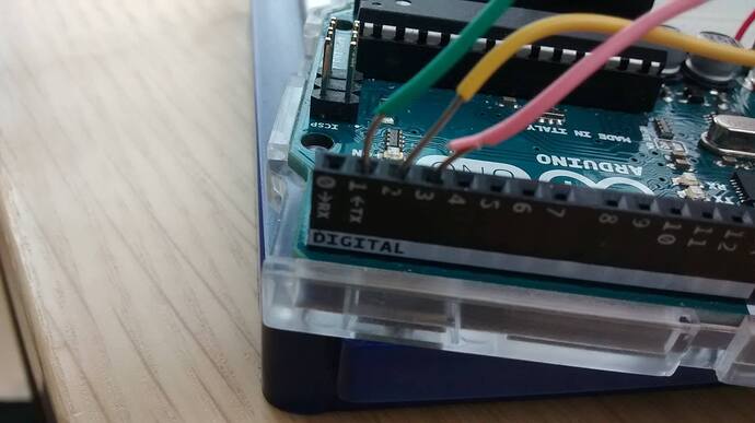

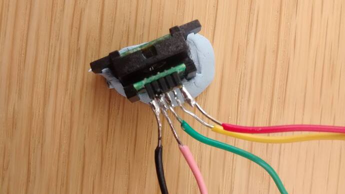

I have tried what was suggested by cattledog, I was unsure what you meant Paul and I'm a bit tight for time so I went for what seemed like the simpler suggestion. See the code below, I managed to get a repeat reading of 0, but no luck within anything other than that. I also tried a few different codes from the playground but no luck. I believe this is because my encoder has an A,B and I pin, as well as a Vcc and GND pin. Please see the connection pictures posted, I believe it is all connected correctly? I'm now very lost as to why I do not get a response from the encoder. Any more help would be great cheers!

The code you posted works with my test encoder. There is an issue with the use of unsigned int for the position in that it won't show negative numbers as positions but that is not your major issue for now. I believe that you have some sort of wiring or hardware problem.
You should perform a simple test with digitalRead() of the A and B pins, when you block the encoder slot completely and then let it be open. You should see verify that they give 1's and 0's. If there is unchanging output, then something is wrong with the wiring.

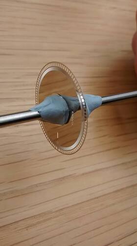

If you indeed see changing output when open and blocked, are you certain that the code wheel is properly aligned in the encoder?
As a different matter, the green wire should not be connected to pin 1. That is the serial TX pin, and connection to it can create problems with the serial output. But since you are indeed seeing output of 0 on the monitor, that's not the major issue either.
Thanks cattledog,
we managed to get the encoder working correctly thanks for all the help. You were correct it was a wire issue getting enough power to the encoder.
