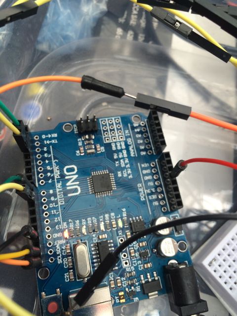

Hello peeps,
I have written my first Arduino project!
The setup is a basic dual timer for opening and closing the door on my chicken coop. So they chooks can be closed in safe at night (22:00/01 and let out in the morning (07:00/01)
Works 'perfectly' (ran for a week) on my bench, without the relay linked up to the actuator but when I link it up to the actuator it seems to get stuck either open or closed. :sob:
I did have lots of serial printing when I was testing, to be sure everything was working on my bench but I took it out for running outside as it is powered from a car battery not a USB linked to a computer that can read it.
Using an Uno, DS3231, 2 Relay module and two override push to make mini buttons.
2-Relay module is used to switch between neg/pos feed for the actuator, to change direction from Open to Close.
The relay module jumper is set to VCC/VCC (not GND) which works on the bench.
In my eyes it is very VERY simple code. (Could be better, with more global vars etc but I wrote it pretty quickly)
Still setup on a breadboard.

Can anyone tell me if they can see anything in the code that would cause this ... and/or recommend a better/different way for me to write the code?
Looking forward to your comments. :grin:
I know it's messy but I am only breadboarding at the moment....
The Open relay is ON, the code dictates it should be all off (in the "else" of the if statement)
To recap, the buttons work, as does the timer.
Sometimes, when using the buttons, the relay stays on. Either open or closed.
And MOST times the same thing happens when the timer triggers an open or close.
Reset the arduino and it works perfectly.
Run it on the bench, from a USB, without the actuator attached to the relay, it works perfectly.
Really struggling to work out what this is... can anyone help?

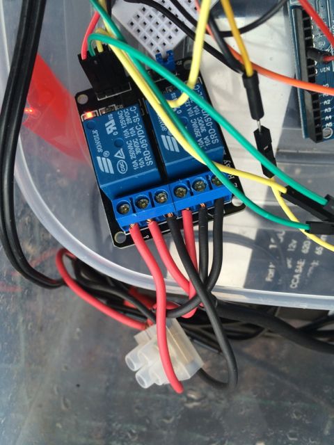

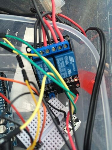

Yes, power is coming from a 12v leisure van battery for both the actuator and the Arduino.
I did some brief calculations and it would last about two weeks, without me linking it up to the solar trickle charger, which I will be doing when it works.
The Relay is connected to the Arduino on the control side, with pins from the Digital 2 & 3 pins to turn it on and off, with VCC and GND also from the Arduino, all on the "pin" side.
The Relay is connected to the Actuator and the battery on the "power" side, using screws terminals.
When one relay is on, the actuator gets power on one cable and earth to the other. Then when the other relay is one, the actuator gets power where it DID have earth and earth where is DID have power, to switch the polarity and change the direction of the actuator.
If both are off, the actuator gets negative down both cables, so it does nothing.
If both are on (this should never happen with the code) then both cables get power, so it does nothing.

You do not seem to have any bypassing capacitors or suppression of any sort on the actuator motor.
Put 0.1uF capacitor across the input of the actuator and also across the 5V to gnd on the protoboard.
A 10uF cap across the 5V and gnd as well.
It could be switching noise from the actuator as you drive then short the input to the motor.
Thanks.. Tom.... :slight_smile:
It is highly likely this is an EMC problem caused by voltage spikes from the motor coupling back into the I2C bus.
Unfortunately extra clock pulses (spikes) cause havoc on an I2C bus and the stock Arduino library causes the Arduino to go into an infinite loop (locks up) waiting for an Ack. There are some other I2C libraries that do have a time-out.
Power the RTC direct from the Arduino with short wires (<5cm). Keep the I2C lines short too. Keep power feeds all together and away from the I2C lines and avoid loops. Ideally twist power feeds with the corresponding return wire (twisted pairs cancel the magnetic fields).
When you have got it working, add a watchdog timer so the Arduino reboots and re-initialises the I2C bus if it locks up. A watchdog is not a cure for the frequent problems you are getting at the moment as the relays will be reset and your chooks may need to spend the night out :frowning: or stay in bed all day :).
If you value your chooks and don't check every operation of the door yourself then I would make a similar completely separately powered system (no good if the door-driving battery is flat you see) that checks 10 minutes later if the door is in the right state and sounds an alarm if it is not!
In a good system the watchdog should never trigger, but I have had a nearby lightning strike cause a running Arduino to reboot on the watchdog! It made me jump out of my skin, so I guess my brain rebooted too. :slight_smile:
Just noticed your relay module is getting power from the RTC breadboard. That is not helping as the relay generates a kickback voltage that puts a transient spike on the +5V line and that passes right through the wiring to the RTC. Ideally use a seperate 5V supply for the relay as indicated here, or add say 470 uF capacitor at the relay module on the 5V feed (note these capacitors are typically electrolytic and polarized, wire them the wrong way around and they go bang).
Remove the JD-VCC jumper and run a wire from separate 5V + to JD-VCC, run a wire from separate 5v - to the GND terminal near JD-VCC, remove the GND wire from Arduino, like this:
NOTE: Power to JD-VCC must be 5V, NOT 12V.

This "separate" power supply. I will use a 12v->5v converter, rather than using the 5v supplied by the Arduino. but it will be linked up to the same battery for source.
I DO have the ability to add another battery for a truly different supply of power. Adds more complexity to the charging process but it is something I COULD do. Is that going too far?
To clarify, here is the new setup.
Which also includes me shortening all the wires and keeping the power/earth and data cables as separate as possible.
Including making sure the power for the relay & actuator doesn't go anywhere near the Adruino.
(Ordered a cheap 12v->5v converter for the relay power, till it arrives I am actually using a spare Arduino as a temp measure!)
