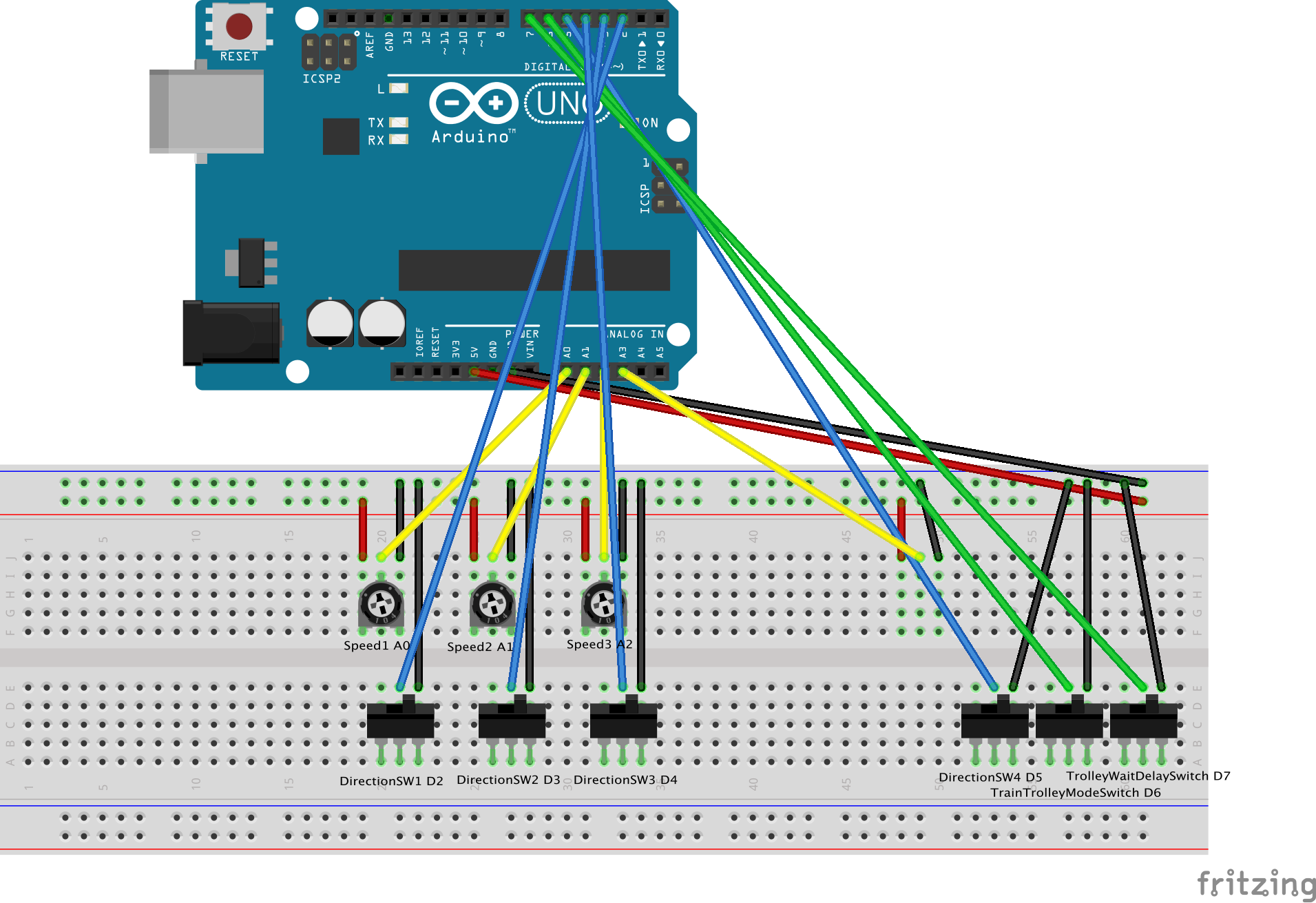

HI,
I'm using the Adafruit Motor Shield V3.
Been through a bunch of tutorials but just can't figure it out.
I have 4 trains connected to the board identified as Train1, Train2, Train3 and Train4.
Each train has a direction switch. DirectionSW1, DirectionSW2, DirectionSW3, and DirectionSW4
Each Train has a POT to control Speed. Speed1, Speed2, Speed3, Speed4
Currently I have an array setup to handle Train1-3. This part works.
For Train4, I have to set it up so it has 2 addition switches. 1 to flip it to Trolley Mode or Train Mode. the other to set the delay for 30-60 seconds.
In Train Mode, it needs to operate the same as the other 3 trains.
When in Trolley Mode, it has to run for a set period of time... Say 30 Seconds then wait for a set period of time (30 or 60 seconds) then reverse direction.
In Trolley Mode the POT for Speed4 needs to control speed as well.
I'm lost. I have tried the mills function but I can never seem to figure out how to make the program work.
My code just keeps getting out of hand and never works for the trolley/train mode switch with the timers.
Not sure how to structure the code.

attached is a frizzing diagram and the code that works for all 4 trains in the array. Again, I need to pull the 4th out of array and add the train/trolley switch with delay function.
Thanks in advance for the help, just really need the help of someone that knows more than I do.

Your code currently treats all 4 trains exactly the same way. Why?
You won't be able to use millis() in a for loop.
You need a state machine instead (see the switch - case construct).
You will need the following states:
  1. set up train 1
  2. set up train 2
  3. set up train 3
  4. If not in trolley mode, set up train 4 and go to state 1, else state 5
  5. start trolley for desired time, if time not up go to state 1, else state 6
  6. stop trolley for desired time. if time not up go to state 1, else reset timers.
    go to state 1.
My first step would be to take the direct setting of speed and direction out of the loop and place it in a separate function; I called it controlTrain.
  set trainspeed and direction for train specified by index
void controlTrain(int index, int direction, int speed)

I hope this gives you a framework to work with. Please note that doTrolley() remembers its last state and direction so switching from trolley mode to train mode to trolley mode might give some surprises.
//Edit: fixed some typos
Sterretje--
Should I start your mplementation by just pasting all of your sections together?
Don't want to go down another rabbit hole..
Thanks again
I tried to implement the blocks Sterretje suggested.
I get compile errors.
Am I even going the right direction trying to implement this code

  //Setup internal PULLUP for trains
  pinMode(DirectionSW1,INPUT_PULLUP); // Direction1 Switch
  pinMode(DirectionSW2,INPUT_PULLUP); // Direction2 Switch
  pinMode(DirectionSW3,INPUT_PULLUP); // Direction3 Switch
  pinMode(DirectionSW4,INPUT_PULLUP); // Direction4 Switch
  // PULLUP mode for Trolley Switches
  pinMode(TrolleyModeSwitch ,INPUT_PULLUP); // TrainTrolleyMode Switch
  pinMode(TrolleyDelaySwitch,INPUT_PULLUP); // TrolleyWaitDelay Switch
  AFMS.begin();  // create with the default frequency 1.6KHz
  //AFMS.begin(1000);  // OR with a different frequency, say 1KHz

Still stuck, can someone please help by telling me what I'm doing wrong?
I appreciate any advise
Thanks
You basically pasted the controlTrain function in the middle of loop() and that is more than likely the root cause of the first error. The other errors are more than likely a result of that. You also have a second loop() function; you can only have one. Below the framework; I've placed my code in there and filled in loop(). You just need to do the setup() and the variable declarations before that.
// define sensible name for trolley mode
#define TROLLEYMODE LOW
  // Loop through trains (trainArray starts at 0)
  for (int trainIndex = 0; trainIndex < 4; trainIndex++)
    // read the speed from the potentiometer (and divide by 4)
    int speed = analogRead(trainSpeeds[trainIndex]) / 4;
    // get the direction from the switch
    int direction = digitalRead(switches[trainIndex]);
    if (trainIndex < 3 || (trainIndex == 3 && digitalRead(TrolleyModeSwitch) != TROLLEYMODE))
      controlTrain(trainIndex, direction, speed);
      doTrolley(trainIndex, speed);

Thank you!!
I appreciate you advise and help, Learned a lot from you.
Question:
Do I need to read the switch TrolleyDelaySwitch (30 or 60) or is that taken care of. Not sure where I should read it.
Thanks again
Not included; you can read it at the beginning of doTrolley and set a delay duration.
  statemachine for trolley mode
void doTrolley(int index, int speed)
  // remember what trolley is doing
  static int trolleystate = 0;
  // remember trolley direction
  static int trolleydirection = LOW;
  // duration of delay
  unsigned long delayduration;
  if(digitalRead(yourPin)  == LOW)
    delayduration(30000);
    delayduration(60000);
and change
      if (doDelay(60000))
to
      if (doDelay(delayduration))
Note that delayduration is read every time so if a delay is in progress and you change the setting it will immediately make the delay shorter or longer.
