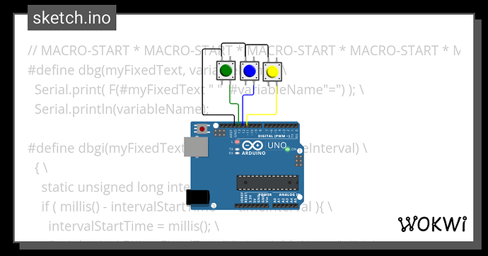

Hi, I have an existing code that I have modified for another use. It goes thru the arduino code check, but I can't get it to work for a reason or another.
Would someone be so kind and direct me to right direction?
Here is piece of that code:

Can you tell us what the code is doing that's wrong, or do you want us to work that out as well?
You must be amazingly patient to have typed all that out! Most people would just use an integer or a byte to hold the values 0 to 34. Why did you do it this way?
Hello tmckeown
In general - arrays and structs are your friends.
Don't duplicate code in your sketch. Write code once - use it multiple times.
And take a view into the BlinkWithOutDelay example to be found in the IDE to design and code some timer functions.
Hi Paul,
Looks like it doesn't do anything, just trying to figure out is it about the code or about the board I'm using?
Because I'm a newbie and this was the way I've done it before
I'm sure the code is doing something. Since we don't know what it is supposed to do then how can we help?
The issue could be in CheckTime() but we don't have a definition for that function.
The definition of CheckTime() is missing. Maybe the problem is in that function.
It is a timer for endurance racing where it shows how much time you have left in the pits. You either have to be there for a 1 minute for a driver change or then 3 minutes if you refuel the car. There is 2 sets of leds. 1 set (3 leds) shows the minutes and 2nd set (5 leds) shows to 10 seconds. In the end when you can drive out of the outs it will blink all eight leds.
Post either or both, but please a complete we can read it and compile it and run it sketch.
Based on what you have shared the code looks like there are rooms full of improvement opportunities.
TIA
a7
seems like you need a function to generate the LED settings simulating a timer counting down in 10 sec increments. not sure you need so many states, maybe none, since that function can be used for any timer amount
Thre is always room for improvement and I'm more than happy to receive ideas how to improve it. Here is the whole code

Here is a wokwi simulation of your code with serial printing through debug-macros.
As far as I can tell it this code works
Setup-Start
"ToL1" mState changed from 0 to 1
"ToL1" mState changed from 1 to 2
"ToL1" mState changed from 2 to 3
"ToL1" mState changed from 3 to 4
"ToL1" mState changed from 4 to 5
"ToL1" mState changed from 5 to 6
"ToL1" mState changed from 6 to 7
best regards Stefan
when i tried simulating it, for the 1 minute case, it went thru state 1-11, returning to state 0. shouldn't it just go thru 6 states?
at least in the simulation the code is doing what is written in the code
case stateELEVEN:  // 1 min gone all green leds flashes
        if (CheckTime(TaskWait, 10000UL))
          digitalWrite(redLED9, HIGH);
          digitalWrite(redLED9, LOW);
          (TaskWait = 15000UL); //initialize the next wait time
          mState = stateZERO; //advance to the next state
Setup-Start
"ToL1" mState changed from 7 to 8
"ToL1" mState changed from 8 to 9
"ToL1" mState changed from 9 to 10
"ToL1" mState changed from 10 to 11
"ToL1" mState changed from 11 to 0
best regards Stefan
