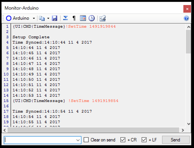

My ESM4 has sample code in the download for getting time & date from a PC into the Arduino and also automatically getting the monitor to put in a timestamp. You may also find that ESM4 will do a lot of what you are trying to achieve.

This might be a solution for your Problem too
