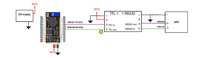

Hi, I am trying to read data from a GPS terminal via serial interface (RS232) using a TnyPico Nano TinyPICO Nano — TinyPICO
Between the Nano and the GPS I have a TTL-RS232 converter Amazon.com
The Nano can send messages which are received correctly and the GPS sends replies back correctly on its TX pin. The voltage of the received signal on the Nano end depends on the supply voltage I give the TTL-RS232 converter, let's say 3.3V. Now when I connect the Nano Rx pin to the TTL rx pin the 3.3V signal gets "cut" and becomes compressed from 3.0V to 3.3V. I can see the shape of these "compressed" signals and the bit sequence correctly with a logic analyzer/oscilloscope, but of course the Nano can't read the data.

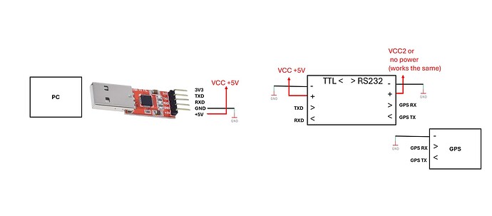

I tried to swap the Nano with any USB to TTL Serial 3.3V chip and I have no problem. It is just the Nano that compresses the signal for some reason. Same issue at different voltages than 3.3V

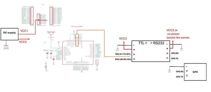

  • The red-and-green schematics are form Nano web page
  • 41-TX-IO1 is from Nano datasheet, it means: pin 41 of Nano board, TX Uart, Arduino IO pin 1.
  • I tried different combinations of VCC1 and VCC2, 3.3V-5V.
  • As for powering the TTL-RS232 converter I didn't see any difference if I power both sides or only one. I was expecting the two sides to take different voltages but they are tied together somehow and both take the highest of the two
  • The GPS has its own internal battery for supply
  • I grounded the GPS with the circuit so the signals have the same reference
These are the signals on RXD pin of the TTL-RS232 converter without connecting the RXD pin of the Nano and after connecting it. The data sequence is correct

Like I said I also tried a FT232 and it works fine. The only difference is that the signals are at 4.7V on TTL side

I think that there is a little bit of confusion. I am not using the chip, but the whole FT232RL board with USB connector, it already has the decoupling internally. And this one works. The problem is just the TinyPico :upside_down_face: In fact I just tested an Arduino Nano 33 IOT and it works perfectly
Post a clear schematic of what you are talking about, be sure to show all connections.
This is the circuit that gives me problems on the RXD-TTL out connection and the signal is compressed
If I open that connection the signal on TTL out is correct
To compare with another device rather than the Pico Nano, this works fine:
It also works with another board, like Arduino Nano IOT instead of the Pico, or another RS232-TTL converter like the AK-3232
Nice pictures but they are missing a lot. How do you know it is compressed and not clipped? Are you using a scope?
I might have used the wrong word. By compressed I meant in amplitude, so I probably should have said clipped? The time duration of the signal is correct, the amplitude is affected.
Yes I used an oscilloscope or a digital analyzer in analog mode. Reposting the figures:
Signal on TTL_out pin With RDX-TTL_out disconnected
Signal on TTL_out pin with RDX-TTL_out connected
That looks like a bad ground or output device (transistor or MOSFET) that drives it low has failed. Try taking the signal and put something in the 2K range to ground and see what it looks like. It should not change much. If that is correct then the converter is overloading the pin. Is there anything else connected to it?
