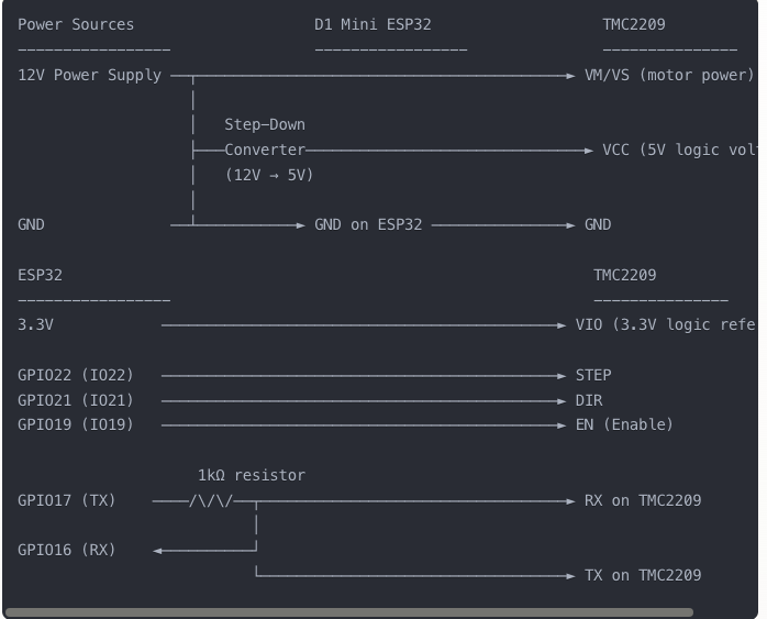

My setup:
  • TMC2209 v1.3 stepper driver
  • AZ Delivery D1 Mini ESP32
  • Want to control the motor via UART communication
I've tried following the manual and various example wirings from other discussions online without success (I've spent days...). At best, I've temporarily achieved one-way communication, both getting the motor to move and receiving responses from the TMC2209, but never simultaneously, and as soon as I add additional features, it stops working.
I'm confused about exactly which pin on the TMC2209 should be used for UART communication. The manual refers to "UART" as a specific pin, but it doesn't seem clearly defined from what I can see.
My questions:
  1. Which specific pin on the TMC2209 should be used for UART communication?
  2. What's required to activate UART and are there other important aspects to consider?
Does anyone have a working wiring diagram for TMC2209 and ESP32 (preferably D1 Mini) for UART control? I would really appreciate a diagram showing all connections, but any help is more than welcome!

Thanks for sharing your setup. I've followed your approach and I'm getting a response of "2" from the test_connection() function, which seems to mean some communication with the driver. However, my motor isn't moving at all.
Could you show in more detail exactly how you connected the 1K resistor between the TX and RX lines and what pin you are using for UART in TMC2209?
do you have a photo of your set / wiring so i can help you. and what model/name TMC2209 do you have?Then i can help you to get yours running.
Great, I'm using a TMC2209 v1.3 stepper driver with my AZ Delivery D1 Mini ESP32.
Here's my current setup:
Common GND between all components.
Did you connect MS1 or/and MS2? Your code mentions DRIVER_ADDRESS 0b00 based on MS1 and MS2, but I wasn't sure if I need to wire them up.
Ok so the MS1 and MS2 pins if you want to microstep you can use a 10k resistor from 5v on MS1. But if you dont want that then you can just use my code as is. The code sets the adress. Your EN pin on the TMC2209 needs to go to a pin on the ESP32 you dont GND the EN pin as you can see in my code as well as DIR and STEP. You can bridge a 1k resistor over TX and RX pin GPIO 16 & 17 on ESP32 and from RX TX tMC2209 UART pin. You only need one TMC2209 connect to UART pin. You dont need to connect anything on MS1 & MS2 on either TMC2209. Use the same pins im using and you wont have any issues. Connect your RX TX from Esp32 to your PDN pin on the TMC2209 just under the CLK pin
I've got the motor moving through STEP/DIR signals, just like in your code. The motor runs quietly and smoothly in StealthChop mode, so the basic functions are working well.
The problem is that the UART communication doesn't work despite multiple attempts. I've tested:
  1. Wiring exactly as shown in the manual with a 1kΩ resistor between TX (GPIO16) and RX (GPIO17) on the ESP32, and both connected to the PDN_UART pin (below CLK) on the TMC2209
  2. Different baud rates (115200, 19200, 9600)
  3. Other pin combinations for UART
  4. Left MS1 and MS2 unconnected as you suggested
I get no responses from the TMC2209 when sending UART-commands.
Do you have any other suggestions on what might be wrong? Could you share your actual wiring, especially how you've connected the resistor and the PDN_UART pin?
