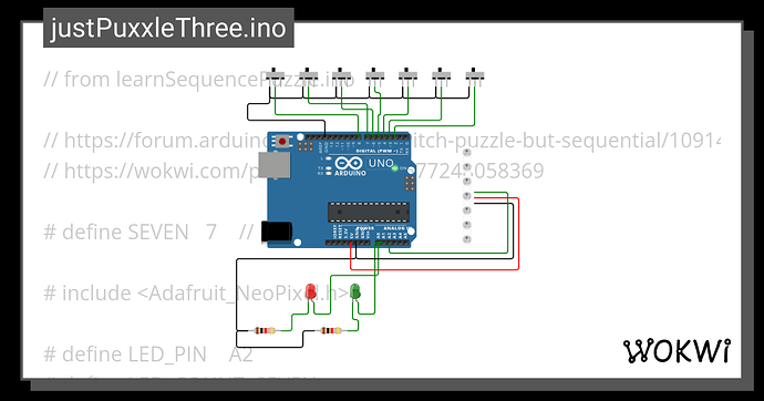

The code below
play with it here
is mostly "Guess in the correct order" from post #12, with changes to newCombo() and scanKeys(), and replaces the pushbuttons with slide switches standing in for toggles.
So entering the combination is just changing the switches in order.
// from learnSequencePuzzle.ino
// https://forum.arduino.cc/t/toggle-switch-puzzle-but-sequential/1091460
// https://wokwi.com/projects/357012577248058369

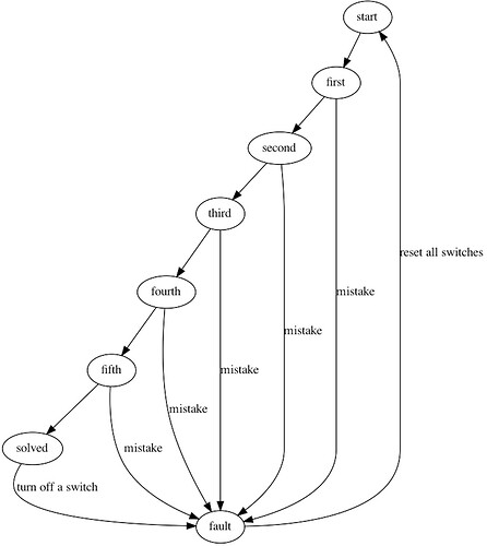

That makes sense. WRT that state diagram, and your description I was having a hard time fitting just the values of the switches as the state of the system and determining progress.
With the choose-all-switches-in-proper-order game, the diagram still works, but the states are the sequence of choices the player made, or rather how far along the vector of proper choices the player had gotten, as nIn is in @alto777's code.
In @alto777's code, I like line 135 as
    disaply.setPixelColor(combo[tt], tt >= nIn ? 0x001010 : 0x00ff00);
Then the LEDs line up with the switches.
Or, start with any positions, and require that each one be changed.
deja vu post #6
Like this?
If you add an additional state variable to @alto777's code to cover the fault/success/start cases, with something like:
enum {START, RUNNING, FAULT, SUCCESS} runstate;
you could then have a state vector of {nIn,runState} that would make it more non-blocking and make it easier to add different fault/reset/start behavior.
Such as:
  • In FAULT mode, make the LEDS for the on-switches display red until they are turned off.
Although it is good to have a plan from the start of a design, you can add a state variable to existing code to make things easier.
(State diagram done with graphviz:
// SM_junkghame.gv -- state machine diagram
digraph finite_state_machine {
start->"first"->"second"->"third"->"fourth"->"fifth"->solved;
fault->start[label="reset all switches"];
"first"->fault[label="mistake"];
"second"->fault[label="mistake"];
"third"->fault[label="mistake"];
"fourth"->fault[label="mistake"];
"fifth"->fault[label="mistake"];
solved -> fault [label="turn off a switch"]
DaveX, That what you posted there is almost exactly what I am after. I modified it to fit my use of 5 switches, added a relay to release when solved and added my OLED screen and some verbiage which I will modify for spacing and aesthetics and such, but it works perfectly. Took me a hot minute and some brain flatulance like remembering to reduce the answers count so to match the total switches in use. I also see how this can be a multi use puzzle to have the players come back a few times to "play" again and just call out another relay in a completely different area of the room.
There is only one issue thus far. it is with the NeoPixel. It operates perfect for the green and red LEDS. It starts off dark, which is good, but as soon as the first answer is given, the 5 LEDS light up white. They change to the correct green and red configuration as they are supposed to, but remain white when they are supposed to be off. I am using the Adafruit High Density Neopixel L-DC 94V-0 E466616. Not sure which one is correct, but I suspect I have the correct ones and not the RGBW Neopixels as the colors operate correctly. Anyways, here is my working code:

I was going to go this way for simplicity sake, but I have the super cool toggle switches with color matching covers and color matching LEDS on the tip when turned on. We all know LEDS make things exponentially cooler.
Write some very simple code that deals only with the NeoPixels, or find and use some example code.
Either way, just don't involve any "thinking" that is coming from even mildly complex logic.
Divide and conquer.
NeoPixel weirdness is almost always a power issue, a noise issue or specifying the wrong kind of strip.
Required reading - NeoPixels Best Practices
HTH
a7
In looking at the WOKWI examples in this post using the NEOPIXELS, they all go "white" when you run the program and make your first choice. Hadn't noticed that previously. Googling things doesn't seem to help, but is this a common thing with the NEO's?
Which WOKWI where? I'm not yet seeing this, please point out one that shows this happen.
Do you mean on the simulator, or when you take code that runs fine to try IRL?
a7
alto, Both Actually. It is faint in the simulation, but I noticed it.
This one I see it on. the LEDS go faint white when the first answer is chosen, right or wrong.
Here too:
That isn't faint white, it's faint cyan and at least once comes from the setPixelColor() call in displayDisplay(), viz:
void displayDisplay()
  for (unsigned char tt = 0; tt < SEVEN; tt++)
    disaply.setPixelColor(tt, tt >= nIn ? 0x001010 : 0x00ff00);
  disaply.show();
It decides whether pixels will be green, 0x00ff00, or… very dim cyan 0x001010.
RGB gets encoded on an unsigned long, with three bytes representing R,G and B intensity each. Going from 0 to 255 decimal or 0 to 0xff.
White full blast 0xffffff
Red 0xff0000
Green 0x00ff00
Yellow 0xffff00
Half bright Red 0x7f0000
and so forth. And now my beach buddy is on the way, she who must not be kept waiting, but I have time to say
read the code! Nothing happens that isn't because the code makes it so.
and
a real shortcoming of the sim is how LEDs and Neos in particular look.
So blame me, but in order to know I've talked to a pixel, I usually don't use 0x000000 black, rather some dim color, like dim cyan, what will be quite brighter IRL.
Appy polly loggies.
a7
