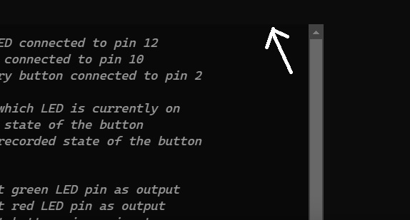

You should be able to copy and paste.
If you place the cursor where the white arrow a "copy" icon appears.
I wasn't signed in to the site, so I wasn't able to paste the code you provided into the app. At least it gave me some time to look at the code and try to figure out how it works.

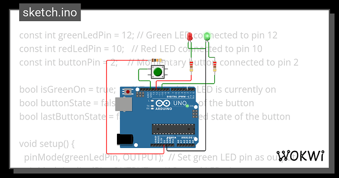

It seems Wowki doesn't like LEDs in series.
Fine on the LED colours, it was a quick write during lunch at work.
Good luck.. Tom.. :smiley: :+1: :coffee: :australia:
It turns out you were right about the LED hookup. Finally got the circuit to work the way I needed it to.
Nice. Thanks for telling.
Please post links to any wokwi simulation, especially ones you say anything at all about. And def any that you claim are the solution to the problem.
I do not know why you couldn't paste your code into someone else's wokwi. I am doing it alla time on a machine that has no idea I am a wokwi supporter and could sign in if I wanted to.
Your diagram shows one resistor serving two LEDs. Each LED needs its own series current limiting resistor; in the wokwi it matters not, the LEDs are magical in the sense that they need no current limiting and are basically indestructable anyway.
Interesting. wokwi does not pretend to very good analog simulation - just enough to get by but this surprises me.

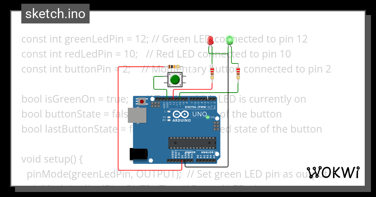

Those leds are in parallel, not in series.
In parallel, each led should have its own resistor..
It does here;
Tom.. :grinning: :+1: :coffee: :australia:
You have the bouncing turned off!
That's cheating or missing the point or both.
Click on the pushbutton in the diagram window and check the "Bounce" box; try it again.

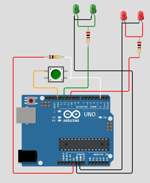

It does not work.
It does work if you turn off the button bounce simulation... which means your button handling is faulty.
Did you test this? If you tested it and it works, you are using very well-behaved buttons.
Your code, enough circuitry to demonstrate it here:
Added: easily fixed as far as I can see. I leave that as an exercise for whomever. I did not have to come to much of an understanding of the code, so I cannot say it is solid.

A suggestion was made to connect the LED in parallel instead of serial, which I did, and the simulated circuit started to function. Green LEDs were lit when the Uno was powered on, button press turned off green and turned on red LEDs, and repeated for each button press. No flashing, just on continuously until next button press. Don't know about turning on or off Bounce function in app, only that the simulation was working. Haven't tested the actual circuit yet, as I am waiting for some of the parts to be delivered.
Link to Wokwi simulation with two red and green leds.
Something in the code is causing a switch in the pin assignments for the red and green LEDs. The code has green led pin = 12, and red led pin = 10, but I have to switch them on the simulated circuit in order of the green LEDs to be on when the simulation starts.
