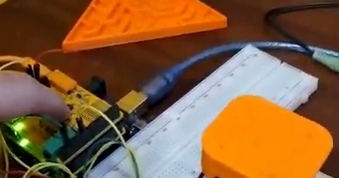

Hey @paulpaulson, I can't thank you enough mate! You're F AWESOME! I can't stress enough how much I was banging my head to get this to work out.
I've attached a drive link of how it acts and what does it look like.
Is there any possible way to smooth out those servos?
