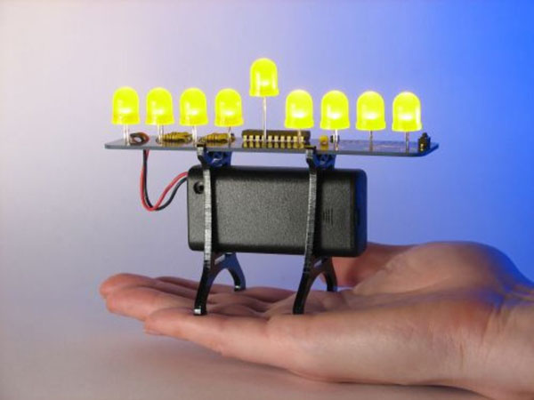

Here is what a 5V kind would look like:
and
and
Now, to use larger, brighter bulbs it is a matter of using something to drive the higher current devices: generally this falls into the area of relays or power FETs.
