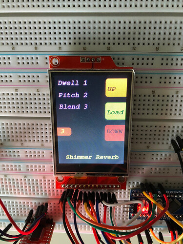

hi, I'm looking for some guidance on my Touch Buttons Project
I'm using ILI9341 display and stm32 bluepill board
I currently have a touch grid set up that prints 1-16 on screen
up button prints 1
select button prints 2
down button prints 3
the other buttons I don't need
what I want is up and down to cycle through 16 numbers (this i'm struggling with)
and the text; shimmer reverb, dwell, pitch, blend, to all change based on the 1-16 position
so position 2 would print; hall reverb, size, depth, reflection
and so on (this I can probably figure out when I have the above figured out)
load button will keep 1-16 position and info on screen,
if load is not pressed within 5 seconds while scrolling through the 16 presets the display is to default to the last loaded position
I also want 3 b100k potentiometers 0v - 3.3v displayed as 0 - 100 values (I have pin 2 from the pots connected to analog inputs, pin 1 to gnd, pin 3 to 3.3v
I've tried a few things in the code, commented out, that didn't quite work out
so just hoping for some advice for things to try or things to read up on
thank you
(I will also be sending high or low to 4 output pins based on the 1-16 position, they connect to a fv1 chip for loading the algorithms, I've done this previously using a rotary encoder so should be able to figure this part out)

got a pot working-ish!
      int (PotValue);
            int (NewValue);
           PotValue = analogRead(PA0);
           NewValue = map(PotValue, 0, 3892, 0, 100);
           tft.print(NewValue);
             tft.fillRoundRect(-10, 230, 70, 30, 8, ILI9341_BLACK);
             tft.setTextColor(ILI9341_GREEN);
             tft.setCursor(10, 250);
             Serial.println(NewValue);

how would I cycle through 16 numbers?
screen currently prints based on the number of the touch grid I press,
what I want is touch button 1 "UP" to cycle up through the numbers 1-16
and touch button 3 "DOWN" to cycle down through the numbers 1-16

Leetut, good job on your previous project — looks great!
It sounds like you are trying to tackle a couple tasks with your interface:
1: Display multiple pages of data & touch controls
2: Timed default transition between pages
3: Capturing analog potentiometer values
From your update, I assume you have (3) figured out.
From what I understand of your project, you will let the user step through 16 “pages”, each providing a different audio preset mode:
  • The UP/DOWN buttons will step through each page. If a user waits on a single page for more than 5 seconds without pressing LOAD, then the page will automatically transition back to the last selected page.
  • A “preset” page will drive 4 GPIOs to the external device to select the current mode.
  • Each page offers 3 analog setting values that are sampled directly from the potentiometer inputs. Presumably these are also communicated somehow to the external device.
  • QUESTION: when you are transitioning between pages (with UP/DOWN), are you simply re-sampling the latest potentiometer values or are you trying to preserve the previous “presets” (ie. The potentiometer values you last had on that page)? If the latter, a rotary encoder might be easier to use than a potentiometer, but I could just be misunderstanding your intended design.
Assuming the above is roughly what you’re after...
For the interface (1) I have listed out a couple general ideas that might be worth considering. There are countless ways to do this, and using a GUI library could certainly make it much easier. Nonetheless, I thought I would share some simple strategies first.
I would recommend having a global variable to keep track of what “page” you are on (eg. curPage). This will be 0..15 depending on which setting page you’d like to show.
Then, you can create a drawPage() function that renders the screen according to curPage. I would also create a global variable pageNeedRedraw to indicate that something has changed requiring you to update it.
In your main loop, you could call drawPage() if pageNeedRedraw is set (drawPage would clear this variable when done). Then, you could check the state of the button inputs. If UP / DOWN, then you would increment/decrement curPage and set pageNeedRedraw to true.
Depending on how you have your potentiometers set up, your main loop probably also continuously reads the ADCs to get the 3 values. You would likely want to set pageNeedRedraw if one of the potentiometer values changed by more than a certain amount (this is the “hysteresis” that PieterP referred to, which can avoid some flickering/noisy output).
For (2), I would save the current millis() into a “lastPageTime” variable any time you update curPage to keep track of how long you have shown the current page. In your main loop if the delta from current millis() and curPageTime is >5000 then force curPage to selectedPage and set pageNeedRedraw.
When the user presses LOAD, then selectedPage can be set to curPage.
Just a few general ideas to get you started...
