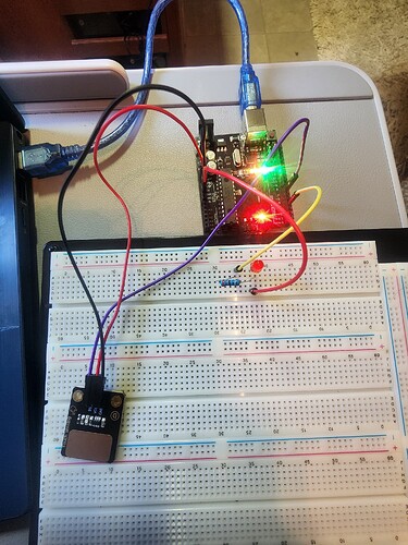

Touch sensor isn't lighting up LED
Brand new to Arduino. Currently trying to make a LED light up with a touch sensor. I believe the coding is in order since it's copied from the Arduino website. The sensor responds to my touch but it doesn't translate into the LED. New components, I've made the LED light up in the past. Can anyone help?`#touchsensor #LED #Breadboard

;; there should only be one there.
Change the LED_PIN to pin 13, and see if the onboard LED lights up.
Leo..
The wire from the touch sensor appears to be plugged into pin 7, not pin 2.
