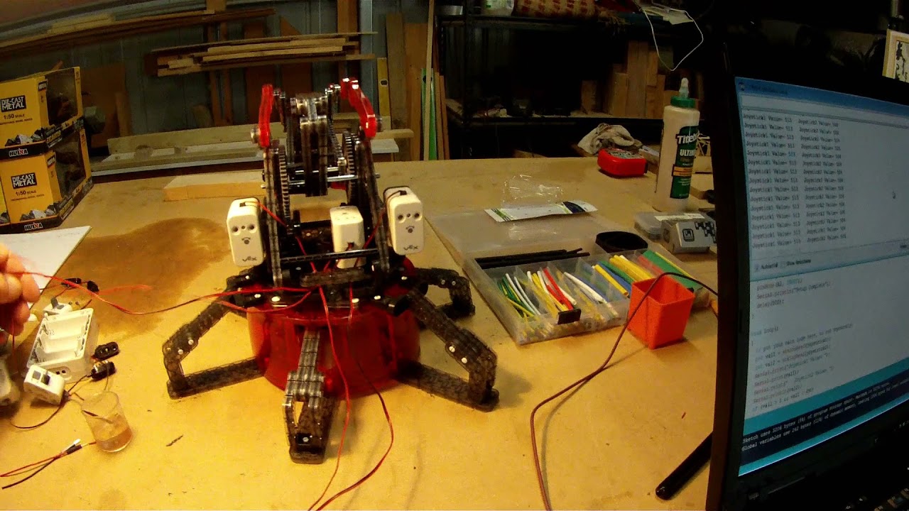

Goodonya TomGeorge. There are some results, which to me is encouraging. I am very interested to see what you learn from those results as that may help me to understand what is going on. Hope the vid is clear enough for you to see.

Thanks for the video.
The code is cycling as it should, but the two values should not change for just the axis of joystick.
Try this and tell me if it is still the same.

Wires are connected correctly, although on this joystick pos and neg are side by side then vert, horz and switch.
Serial monitor prints basically the same except this time it said set up complete first.

To be sure.. To be sure the analog channels were properly read.
Okay ,the thing is only one value should change for each axis.
It looks like only one axis of motion changes both analog changes, is that right.
Can you measure the voltage between A0 and gnd and move the joystick, find which axis changes the voltage and what the voltages are.
Then do the same with A1.
A0 voltage should only change with either fwd/back OR left/right.
Same for A1.
