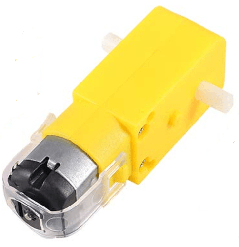

I'm looking at the motor below. They come with single or dual axles which is great. I don't know if I can control them well enough to just move 45° or 90° accurately and then stop.

"Low RPM comes from geared motors..." The yellow one above is geared 1:48. It has maximum torque: 800gf cm and max 200 rpm. It's powerful enough to easily lift a plastic or wood 6 inch leg. I can get them @ 1:120.
I was hoping someone here had enough experience to tell me whether or not I can control it well enough to make it turn between 15° and 120° and stop reliably. I can use PWM to slow them down & smooth movement. Yes???
If nobody here knows I suppose I can run some tests to find out. I have 4 of them.
With the dual axle at one end I can slip it inside the torso or leg with the axles at the bottom. Can I do something like that and control it?

Again, I'm convinced that yellow motor can handle anything the leg can throw at it - but can I control it?

PWM driving dc motor should be ok.
Given the gear reduction required they would stop instantly when power was removed.
Worm gear output would be best as beyond around 40 degrees of the gear cut, they will not drive backwards.
Naturally under these conditions , thrust bearings would be essential otherwise the gears will lock up.
With that considered, it would in most cases require ones own design and build gearbox.
Not difficult, done it myself many times but then that depends on your skilset.
Given the query, possibly not great in that respect.
Again a plus for a wheeled robot to cut your teeth on.
