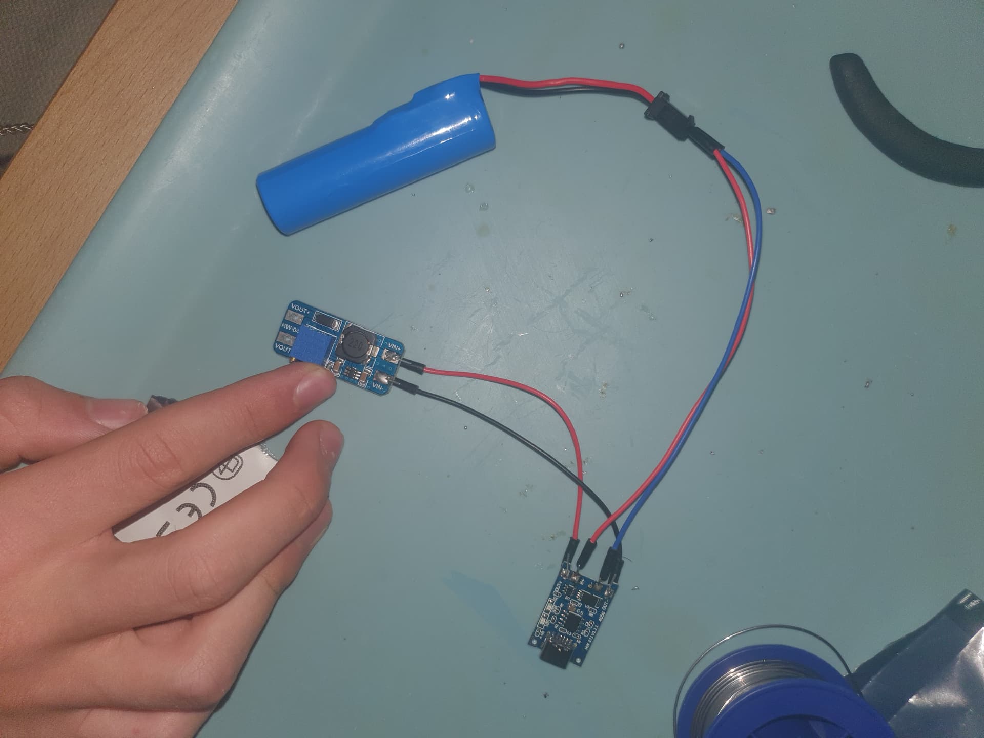

For my first electronics project I needed a 3.7v 3000mah 18650 lithium ion battery to power the whole project. I thought of charging it in parallel using a tp4056 module of amazon and then boosting its output to a required 5V using the mt3608 module. I completed the whole soldering and stuff which is very rough and not polished at all, and plugged in a battery for the first time using the wires (You can see it all on the picture) note that I planned perfectly the wiring and I am perfectly sure that the wiring is perfect. I tested the output voltage going out from the MT3608 and realised it was extremely low(2,7V) even though I had previously set rhe output voltage to be exactly 5v on the module. So i was kind of shocked. I tried with multiple batteries and it did the same. Then I tried to plug in the usb c cable and it got back to normal. Completly normal, it doesnt make any sense. The voltage on each pins got back to the normal standart that I previously thought were goind to be the norm : 4v on B+/B- 4V on OUT+/OUT- 4V on Vin+/Vin- and 5V on Vout. Compared to the previous voltages. The module gave me the right voltage no matter what only after I plugged in at least once the usbc and seem to actually keep the volatge for a long period of time. Like what ? And when I plugged in the usbc again and again it didnt affect any of the previously mentioned measurments.
I don't see any parallel 18650's and that is a GOOD thing as they are prone to catching fire that way if you don't have the proper protections.

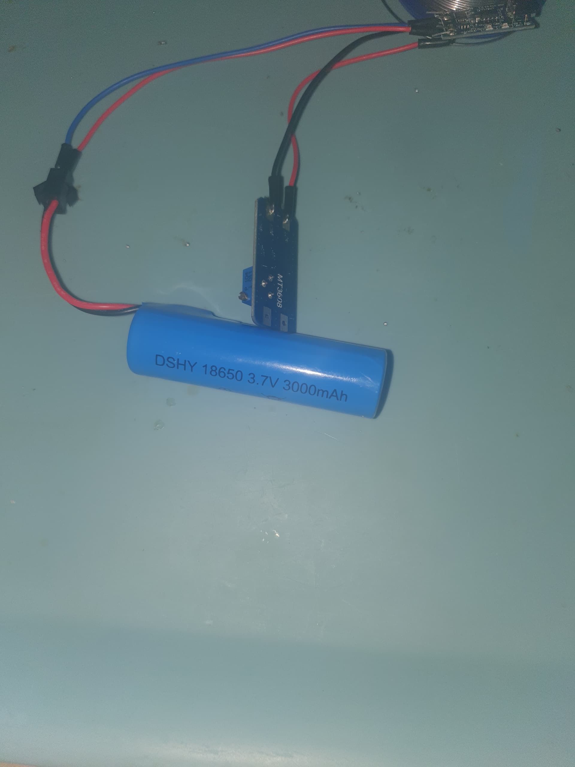

The battery pictured appears to be a 14500 800mAh battery.
If you measured voltage while unbder load then that is not unusual. If you want to check the voltage of the battery measure it with no load.
Sorry no the lithium battery is really a 18650 3000mAh battery. Here is the picture. I measured the voltage at the output pins of the mt3608 because I need it to be 5v and that's the problem. I dont eeally know what to do should I just keep the project up by just plugging the usbc once and calling it a day ?
Looks smaller, but a ruler can verify.
Disconnect the battery and measure the battery voltage.

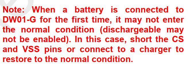

Also, is it possible that this excerpt from a DW01 datasheet is involved in some way?
If so, it's not a bug, it's a feature. You can test if this is the problem by temporarily connecting the battery negative terminal to OUT- on the TP4056 module, which bypasses the protection circuit.
The voltage going into B+ and B - was 4.0V which is the battery voltage, however the voltage dropped at out+ and out-to approximately 2.3V. How should I connect the battery without having to tear everything down ?
