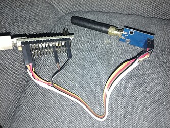

TPMS transcoder for Renault zoe2 with CC1101 and Arduino Nano
I tried to put a Clio TPMS sensor E24 10R-041328 in my front wheel but unfortunately, they are not seen by the zoe2 (Zoe2 original TPMS sensor: 407004CB0B).
The signals are very similar that's why I tried it.
In this project, I will transcode the clio signal to a Zoe signal.
If you want to do a similar transcoding, it is strongly recommended to have a SDR ( software-defined ) radio.
My material and software for SDR:
My material for transcoder:
Pictures of the sensors are on renault-zoe.forumpro.fr (in french)
The dataflow for this project:
More coming soon...
lots of part numbers, but none of them are definitive. As we all know Nano has become a generic term, there are many different ones available with different processors. It appears it is basically becoming a form factor. I looked up CC1101 and got several totally different things. With the information supplied I do not have a clue as to what you want or what is coming soon.
@gilshultz I update my first post with links to software and hardware and a dataflow diagram.
Any CC1101 and Arduino 3.3V which can use the SmartRC-CC1101-Driver-Lib should work: ESP8266, ESP32. For 5V Arduino (Nano, UNO, MEGA) as explained in the library , "A logic level converter is recommended for arduino. It also works well without. Use at your own risk."

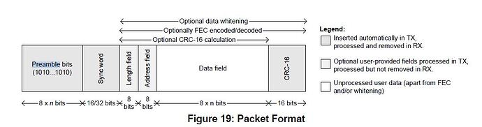

According to CC1101 manual:
CC1101 can generate:
  • Preamble: our is 55 55
  • Synch word: our is 55 56
  • CRC calculation
  • Manchester encoding
But we can use none of them because:
  • CC1101 send lenght with Preamble/Synch Word
  • CRC is CRC16 and we need CRC 8
  • Manchester encoding will remove 0 at beginning/end
    That's why we use Manchester encoded data.

A made a mistake in my previous post. I am not using a nano 3.3V but a nano V3.3 (old bootloader): this is a 5V arduino! Previous post edited are now correct!
Here is a picture of my hardware wired:
We have here the same problem for receive:
  • We cannot use ELECHOUSE_cc1101.ReceiveData(buffer) because it is supposed to contain length: low level functions will be used.
  • CC1101 hardware Manchester decoding cannot be used
But good news: Synch Word can be used. This will be 55 56 for us. The sensor send 55 55 55 56 but the CC1101 cannot detect that 32 bit Synch word so only last 16 bits wil be used!
Important change in the config between send and receive are:
Packet length is 18 because we read after synch word: ELECHOUSE_cc1101.setPacketLength(18)
ELECHOUSE_cc1101.setSyncMode(1) and ELECHOUSE_cc1101.setSyncWord(0x55, 0x56); because me use synch word

  ELECHOUSE_cc1101.setCCMode(1);              // set config for internal transmission mode.
  ELECHOUSE_cc1101.setModulation(0);          // set modulation mode. 0 = 2-FSK, 1 = GFSK, 2 = ASK/OOK, 3 = 4-FSK, 4 = MSK.
  ELECHOUSE_cc1101.setMHZ(CC1101_FREQUENCY);  // Here you can set your basic frequency. The lib calculates the frequency automatically (default = 433.92).The cc1101 can: 300-348 MHZ, 387-464MHZ and 779-928MHZ. Read More info from datasheet.
  ELECHOUSE_cc1101.setDeviation(35);          //47.60// Set the Frequency deviation in kHz. Value from 1.58 to 380.85. Default is 47.60 kHz.
  ELECHOUSE_cc1101.setChannel(0);             // Set the Channelnumber from 0 to 255. Default is cahnnel 0.
  ELECHOUSE_cc1101.setChsp(199.95);           // The channel spacing is multiplied by the channel number CHAN and added to the base frequency in kHz. Value from 25.39 to 405.45. Default is 199.95 kHz.
  ELECHOUSE_cc1101.setRxBW(812.50);           // Set the Receive Bandwidth in kHz. Value from 58.03 to 812.50. Default is 812.50 kHz.
  ELECHOUSE_cc1101.setDRate(19.23);           //18.5  // Set the Data Rate in kBaud. Value from 0.02 to 1621.83. Default is 99.97 kBaud!
  ELECHOUSE_cc1101.setPA(10);                 // Set TxPower. The following settings are possible depending on the frequency band.  (-30  -20  -15  -10  -6    0    5    7    10   11   12) Default is max!
  ELECHOUSE_cc1101.setSyncWord(0x55, 0x56);   // Set sync word. Must be the same for the transmitter and receiver. (Syncword high, Syncword low)
  ELECHOUSE_cc1101.setAdrChk(0);              // Controls address check configuration of received packages. 0 = No address check. 1 = Address check, no broadcast. 2 = Address check and 0 (0x00) broadcast. 3 = Address check and 0 (0x00) and 255 (0xFF) broadcast.
  ELECHOUSE_cc1101.setAddr(0);                // Address used for packet filtration. Optional broadcast addresses are 0 (0x00) and 255 (0xFF).
  ELECHOUSE_cc1101.setWhiteData(0);           // Turn data whitening on / off. 0 = Whitening off. 1 = Whitening on.
  ELECHOUSE_cc1101.setPktFormat(0);           // Format of RX and TX data. 0 = Normal mode, use FIFOs for RX and TX. 1 = Synchronous serial mode, Data in on GDO0 and data out on either of the GDOx pins. 2 = Random TX mode; sends random data using PN9 generator. Used for test. Works as normal mode, setting 0 (00), in RX. 3 = Asynchronous serial mode, Data in on GDO0 and data out on either of the GDOx pins.
  ELECHOUSE_cc1101.setLengthConfig(0);        //!!!  // 0 = Fixed packet length mode. 1 = Variable packet length mode. 2 = Infinite packet length mode. 3 = Reserved
  ELECHOUSE_cc1101.setCrc(0);                 // 1 = CRC calculation in TX and CRC check in RX enabled. 0 = CRC disabled for TX and RX.
  ELECHOUSE_cc1101.setCRC_AF(0);              // Enable automatic flush of RX FIFO when CRC is not OK. This requires that only one packet is in the RXIFIFO and that packet length is limited to the RX FIFO size.
  ELECHOUSE_cc1101.setDcFilterOff(0);         // Disable digital DC blocking filter before demodulator. Only for data rates ≤ 250 kBaud The recommended IF frequency changes when the DC blocking is disabled. 1 = Disable (current optimized). 0 = Enable (better sensitivity).
  ELECHOUSE_cc1101.setManchester(0);          // Enables Manchester encoding/decoding. 0 = Disable. 1 = Enable.
  ELECHOUSE_cc1101.setFEC(0);                 // Enable Forward Error Correction (FEC) with interleaving for packet payload (Only supported for fixed packet length mode. 0 = Disable. 1 = Enable.
  ELECHOUSE_cc1101.setPRE(0);                 // Sets the minimum number of preamble bytes to be transmitted. Values: 0 : 2, 1 : 3, 2 : 4, 3 : 6, 4 : 8, 5 : 12, 6 : 16, 7 : 24
  ELECHOUSE_cc1101.setPQT(0);                 // Preamble quality estimator threshold. The preamble quality estimator increases an internal counter by one each time a bit is received that is different from the previous bit, and decreases the counter by 8 each time a bit is received that is the same as the last bit. A threshold of 4∙PQT for this counter is used to gate sync word detection. When PQT=0 a sync word is always accepted.
  ELECHOUSE_cc1101.setAppendStatus(0);        // When enabled, two status bytes will be appended to the payload of the packet. The status bytes contain RSSI and LQI values, as well as CRC OK.
  Serial.println("CC1101 initialized.");
  //Start RX
  ELECHOUSE_cc1101.setPacketLength(18);
  ELECHOUSE_cc1101.setSyncMode(1);          //sync on 0x5556
  ELECHOUSE_cc1101.SpiStrobe(CC1101_SFRX);  //flush fifo
  ELECHOUSE_cc1101.SpiStrobe(CC1101_SRX);   //enable rx
  Serial.println("Rx Mode");

The code can certainly be optimised.
A further step would be a code able to transcode any TPMS but that's a huge job.
I hope that my posts will help you to decode/encode/transcode your own TPMS: only one step could be usefull to you if your project is for example:
  • Fake TPMS sender
  • Show TPMS data on LCD
  • TPMS alarm buzzer
Have you been able to solve problem with sending twice the package? Any improvements?
I'm also trying to write my own tpms signal simulator but as for now it seems the generated signal by cc1101 is much different than genuine signal from continental sensors.
Btw, do you know which company is delivering sensor for Renault?
No, I still need to send twice the package. This should be a CC1101 bug.
No. You can find pictures of the sensors here: renault-zoe.forumpro.fr
Can you post your rtl_433 decoded data.
Well, Unfortunately I was not able to generate signal which would be accepted by my car or by tpms activator tools (used to make tpms sensors active). I looked on this signal and it seems to be very different from the signal generated by true tpms sensors...
