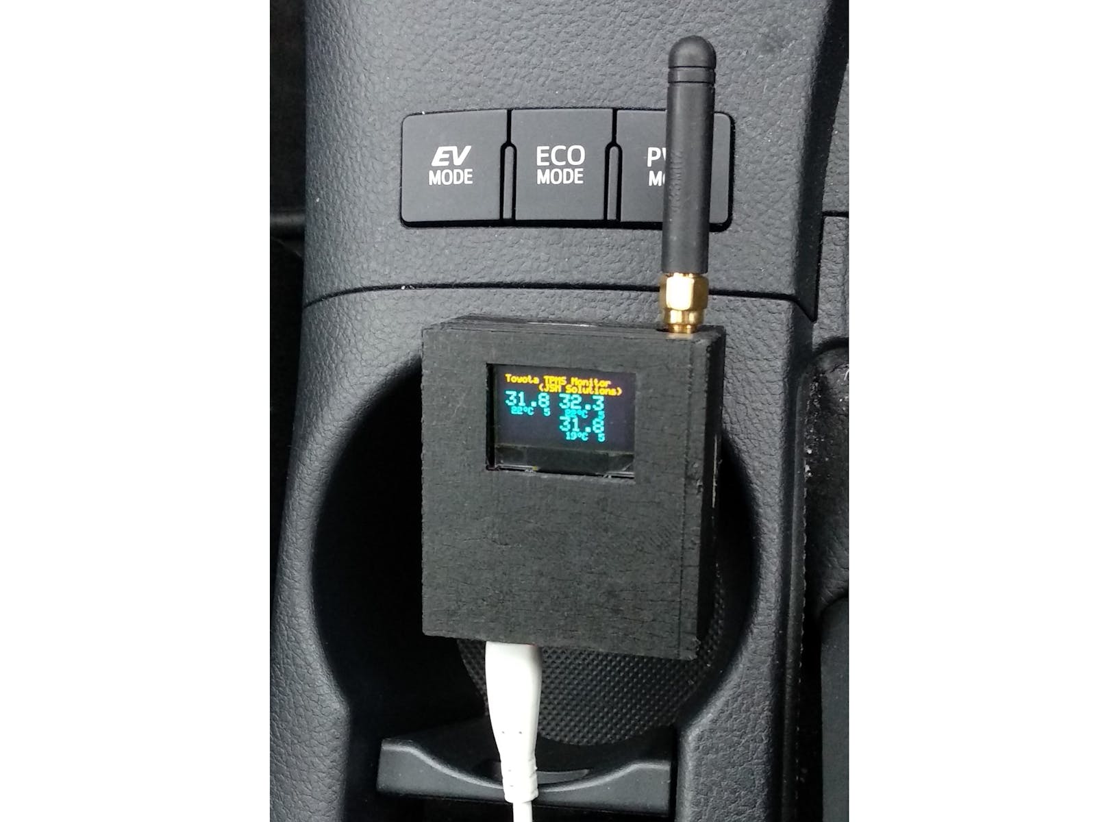

This might be helpful:
I highly recommend that page, there I found the solution I was looking for, I was able to use the rp2040 seed chip, the rp2040- zero, use a round screen for my car, there is a lot of help from the author and some users
