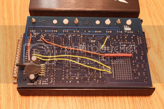

Since finishing the MegaSquirt EMS and having everything go phenomenally well, I’ve started to realize the sky is the limit. A friend of mine has a ProEFI (another brand of EMS) which is one of the more expensive (try upwards of $5000 compared to $400) but much more technologically advanced EMS’s on the market. ProEFI has a Traction Control feature. This system uses wheel sensors to determine if the car is losing traction. Once the system determines that the car is losing traction, it limits the engines power; which helps the car regain traction. I kicked around the idea of trying to add this to my MegaSquirt (I did some research and it sounds like people have added it to the MS3 versions; I’m on MS2. Though it sounds like it’s possible). After more research and talking with some friends who have more experience, it started to make sense to have this be independent of the MegaSquirt.
So the general idea is: Detect if the rear wheels are spinning, if they are then limit engine power until they are no longer spinning.

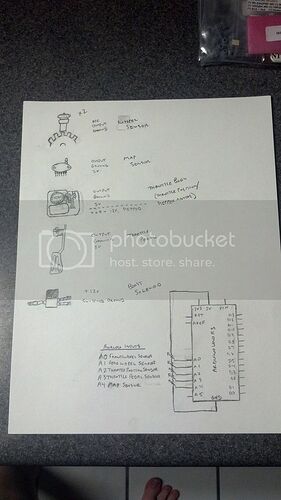

So on to the electronics. Here’s a basic sketch of the inputs.

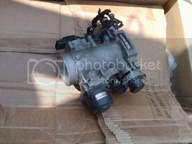

Mazda RX8 DBW Throttle body (Nearly the exact same dimensions as my throttle body)

From what I’ve researched, all my inputs (Map sensor, Wheel sensor, Throttle pedal position sensor and Throttle body position sensor) all have three pins. Which are: 1. 5v, 2. Reference, 3. Ground. Also, all my outputs (Throttle Motor and Boost Solenoid) have two pins. Which are: 1. 12v, 2. Ground. From what I gathered, both of these (Throttle Motor and Boost Solenoid) will be controlled through Pulse Width Modulation (PWM).
Since I’m now switching from Drive By Cable (using a cable to control the throttle body) to Drive By Wire (using a micro controller to control the throttle body) I will have to also code the DBW Throttle Motor to work based off the DBW Throttle Pedal. So far I’ve been able to hook the RX8 Throttle Pedal Sensor up to the Arduino and using the analogRead() and the Serial.println(), I’ve been able to get a reading from the pedal. I used the map() function to convert the input from it’s 0-1023 to 0-100 (for percentage).
Once I had the pedal reading 0-100% I started messing around with the throttle body. I was able to do the same thing for the Throttle Body Position Sensor (I converted it to 0-100 also). Once these two were working as inputs, I started messing with the Throttle Motor. I took a 12v source (a car battery) and gave power and ground to the two pins for the Throttle Motor; it turned open extremely fast. If I switch the power and ground to the opposite pins, it tried to turn the other direction. I started researching how to control stepper motors through PWM and found this:
http://bildr.org/2011/03/high-power-control-with-arduino-and-tip120/
I used the second diagram:
http://bildr.org/blog/wp-content/uploads/2011/03/tip120-motor.png
But I didn’t have the components that they use in this example. I looked through the stuff that came with my Boost Solenoid and found a transistor and some other components. I hooked everything up the way the second diagram above suggested and was able to use the analogWrite() function to write out to the motor through PWM. Finally I was able to get all three parts working individually (Throttle Pedal Sensor, Throttle Body Sensor, and Throttle Motor). Since the analogWrite() uses a value of between 0-255, I figured I would map the Throttle Pedal Sensor to 0-255 and write the value directly to the Throttle Motor. This resulted in the Throttle flying open extremely fast (once I pressed the Throttle Pedal down just the slightest bit) and staying there until I shut everything off (regardless of the position of the Throttle Pedal after initially pushing it down). I was pretty confused as to why 0-255 wasn’t the same as 0-100%. As I read about PWM and duty cycle it started to make a little more sense, but I’m still a little confused about things. I then mapped the Throttle Pedal Sensor to 0-120. When I did this, if I recall correctly, the Throttle Motor opened and closed relative to the Throttle Pedal (though a little laggy).
Now I have control over the Throttle Motor by using the Throttle Pedal. I don’t feel safe quite yet running it on my car, since it doesn’t react as quick and as consistent as I’d like. I think it will take some more playing around with. I think I’m going to have to add some logic to check where the Throttle Motor is at (based on the Throttle Body Sensor) and compare it to the position of the Throttle Pedal Sensor. For example, if the Throttle Body Sensor is less than the Throttle Pedal Sensor, keep opening the Throttle until the Throttle Body Sensor is equal to or greater than the Throttle Pedal Sensor (then else if the Throttle Body Sensor is greater than the Throttle Pedal Sensor, do the opposite).

Just one unsolicited comment, nothing to do with arduino - closing the throttle and the wastegate feed is redundant - backing off the throttle or opening the wastegate will accomplish the same thing. The turbo will slow down and boost will decrease with either one. The throttle is a little better lever IMHO if you have an internal wastegate that is probably questionably sized :slight_smile:
I think more sophisticated implementations will retard timing back first, but I personally think that's only useful on the edge case where you barely have enough power to break traction (as opposed to 5X or 10X the torque the tires can take, timing will never get you there...)

Just one unsolicited comment, nothing to do with arduino - closing the throttle and the wastegate feed is redundant - backing off the throttle or opening the wastegate will accomplish the same thing. The turbo will slow down and boost will decrease with either one. The throttle is a little better lever IMHO if you have an internal wastegate that is probably questionably sized :)?

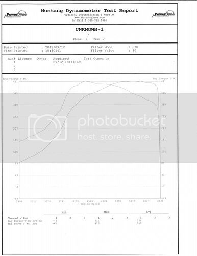

That's a good point. I suppose I should do one or the other. I made 350rwhp at 14psi and 410rwhp at 20psi, so adjusting boost on my setup could only limit 61rwhp; which isn't going to stop it from spinning on a street tire (though a stickier tire like a slick, cheater slick, or drag radial might make a considerable difference). So it seems that it would make sense to only do throttle control. But for testing and experimenting, I'll probably work on both throttle and boost control, but keep them independent of each other. Maybe testing will prove that limiting boost before limiting throttle will make a difference. But based on the point you made, it shouldn't. But there could be other factors like: if you started closing the throttle because of wheel spin, once you have the desired amount of traction, how fast would the engine regain power once the throttle is reapplied? And on the flip side, if you started adjusting boost down because of wheel spin, then started closing throttle because of continued wheel spin, once you have the desired amount of traction, how fast would the engine regain power if boost was reapplied first, and then throttle was reapplied second? Would one method regain power faster than the other? If so, I'm guessing it would be a difference of milliseconds and probably wouldn't be humanly noticeable. If it was just throttle based, it would most likely take longer for the air to pass through the intake, go through the combustion cycle, expel the exhaust from the cylinder, and spool the turbo; opposed to just allowing more exhaust gas to pass through the turbo by adjusting the waste-gate. But again, we're probably talking about milliseconds. Thoughts?

Tough to know what the best control strategy is, and I suspect you'll have to experiment. Fuel cut is a bad idea all round, if your engine is at all highly tuned. It means your engine will run lean and hot every time the cut comes in or out. Walking spark cut seems to be a much more successful strategy and I've used it on a low boost supercharged V8 without any complications. However, spark cut means your exhaust is going to be detonating like mad and that's not good for it or your turbo. One nice thing about the spark cut is that it's very obvious to the driver (assuming you aren't brain dead) so you can use that feedback to teach yourself to drive around the wheelspin rather than rely completely on the aid. So to some extent the best answer will depend on how you anticipate using this device.
Timing retard means that all the heat that isn't being converted into power any more is going to be dumped into the exhaust, and especially into the exhaust valves. I would have thought that was already a concern and dumping yet more heat would just make the problem worse. With the power levels you're talking about I imagine that it would be possible to have the control operate for seconds at a time and that is definitely too longer to be running at full power with a delayed spark. A throttle stretcher would be much kinder that any of these options from the engine's point of view.
One thing I noticed on the RaceLogic traction control is that it allows more slip in a straight line than in cornering - which makes sense when you consider the circle of friction. You can use differential sensing on un-driven wheels to detect cornering.

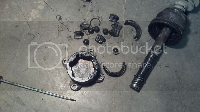

Had to chuckle at the broken lobros. I've never broken one there, on my setup the half shafts are the weak link. I've got a design now that will last for a few years, but they always go eventually. Curiously, every single half shaft failure has been when I was pulling away gently and not quite spinning the wheels - which your grip theory will tell you is where you are getting peak traction. So you may find that by getting a better hook-up you actually give your transmission a harder time, although there's less smoke and noise.
I was told that these joints would break with RPM launches on a sticky tire. Guess I had to see first hand… My usual course of action is, if it breaks, build it stronger. I broke my first two LSD’s, then bought everything to make the third one stronger (Detroit True Trac, new bearings, seals, lower gear ratio). Then I broke my stock trans. Here’s what happened there:
It beat the hell out of it for 2-3 years, so I guess it did pretty well for the abuse I put on it. I upgraded to the transmission that came stock mated to the motor that I swapped into my car (the stock motor was a 5M-GE and the stock transmission was a W58; I swapped to a 7M-GTE and a R154). Also, since I changed transmission I needed a custom driveshaft, so I now have a one piece.

I don't know if that's what that picture shows. Anyway, throttle-by-wire systems are getting more common and it would be kind of cool to have an engine that had automatic launch control and automatic rev matching and so on which would become possible once you have the basic system in place. Just make sure that you consider all the failure modes and ensure the t-b-w system will kill the engine if it loses control over the throttle.
The picture shows a 2JZ-GTE throttle body, it utilizes two butterflies. The front butterfly is controlled electronically and the back is controlled by cable (which actually has two cables, one for the throttle pedal, and one for the cruise control). Either way I plan to be thorough in dealing with safety. But it makes sense to try to use a throttle stretcher if it can eliminate two issues: Mounting a different throttle body and ensuring safety.

But if your throttle body has two butterflies in series then that would be an even better solution. You would use the cable-operated throttle for manual control and the 'TC' throttle would normally be wide open. TC can close its butterfly to reduce the power but it can only ever take power away - it can never add power to the manual throttle setting and can never prevent the driver from reducing power manually. I think you're on the right lines with that dual throttle body.
Sorry, I think I just created some confusion. The throttle body pictured isn't the one on my car, this is what I have:
http://www.godspeedperformance.com/universal-70mm-throttle-body-w-adapter-godspeed-project-p-246835.html
I only posted this picture to show another way to approach the issue; a different way of reducing throttle safely. I'm not going to be able to use this entire throttle body, there isn't enough room in my case.
If a traction control butterfly like this came stock on my engine I would obviously be using it, I can't deny it would be the most safe solution that we've discussed yet. But in my case, if I cold find a 70mm TC throttle (which is actually the size of the 2JZGTE throttle) that's only 3-4 inches long (for example, I might be able to take the 2JZGTE throttle body and cut the TC throttle off, then add it to a my car right before the mechanical throttle) and then cut 3-4 inches out of the intercooler pipe right before the mechanical throttle, put a coupler and t bolt clamps on each side and be on my way (the only issue I can think of would be telling the EMS the throttle position, it would be reading off the mechanical throttle and not the electric, so if the electric took power away the EMS wouldn't know. I'm not sure if this would be a problem.). The throttle stretcher would require the least modification and it would be simple to switch it back to the way it was before if ever needed, which I would prefer.

That sounds nearly identical to the 2JZGTE throttle that I linked in the picture in a prior post. I agree, if it was a little simpler to install it would work perfectly.
