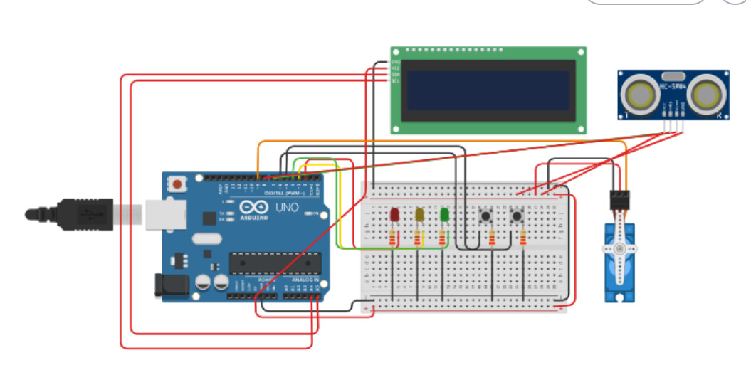

Hello,
I am working on a barrier project that involves traffic lights and an obstacle detection system. The barrier will lift when an obstacle is detected and lower when there is none.
I/O:
  1. Red LED on pin 2, Yellow LED on pin 3, Green LED on pin 4
  2. Two switches on pin 5 and pin 6
  3. Ultrasonic sensor HC-SR04
  • trigPin on pin 7
  • echoPin on pin 8
  1. Servo motor on pin 9
I am currently facing an issue with checking for obstacles. Can you help me?

Hi, welcome to the community
Hope u have a great experience here.
There are some needed improvements that u can make to your post:
  1. Add the code in code tags like this: hello world
  2. Your question "im facing issue with checking for obstacles is too vague. pls clear whats the exact problem. for eg. "I am getting random values in the serial monitor" or "sensor is not detecting at all no matter where the object is"
  3. Finally, when asking a question about a physical project, always include a circuit diagram/schematic. It helps us to troubleshoot better.
    Pls dont keep the title as "HELP ME PLSSSS" instead keep it something informative "Problem in receiving values from ultrasonic sensor" or so.
Hand drawn and photographed wiring diagram. Use the IDE Tools Menu Auto Format option to make code readable. Post all code and verbose error logs in code tags.
That will get you better support.
I dont recommend using ultrasonic sensor..
It only bounce back on solid plane material..
Multiple sensor is needed.
And probably at specific distance
