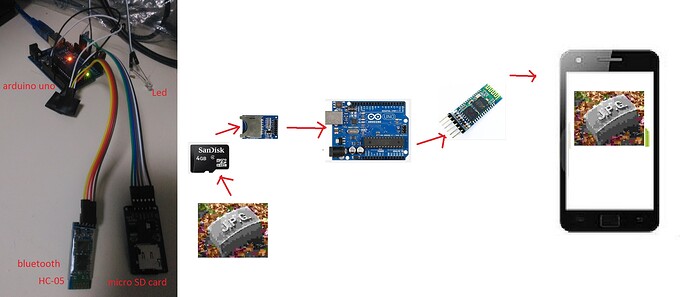

Hello, this is my first arduino project: sending a file (jpeg, pdf, txt) from an arduino sd card module to android phone using arduino uno and bluetooth module bt-05
It's possible with this hardware?
have you any suggestion about the android app to receive the file?
thank you
For text, yes. See reply # 1. Any Bluetooth terminal programme will suffice
For text, yes.
The process of transferring the bytes in a file is not restricted to transferring only bytes that represent printable characters in an ASCII table.
So, the comment should be:
For any kind of file, yes.
Paul, so you think it's possible to send a picture (exp: jpeg) to an android device using arduino uno, HC-05 and micro sd card shield?
