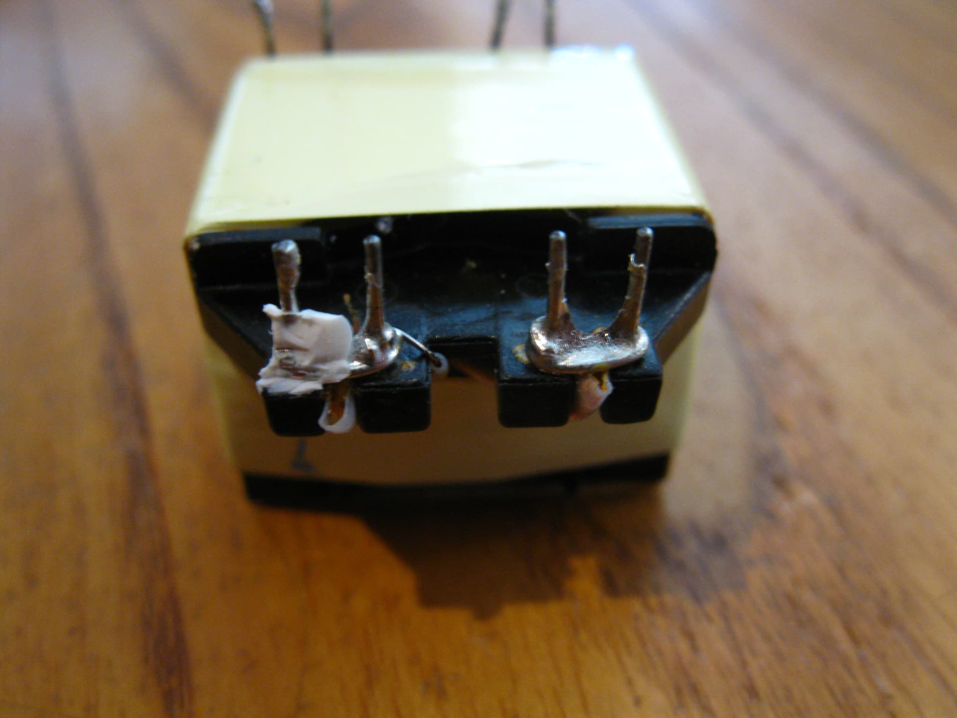

I have desoldered this transformer from an old power supply plugpack, but googling the numbers on it does not return anything.
Does anyone know how to identify what kind of transformer this is?

It certainly looks like a high frequency transformer. Undoubtedly a special made for that converter design. If you pull some of the tape off you should see the "core" is made of a ferrite material.
It makes a good paperweight but functionally useless.

So this plugpack had a couple of transistors and ICs in it? And was quite lightweight?
If so, it was a switchmode supply and the transformer operates at a frequency well above the audio range. It does not operate at 50 Hz. :roll_eyes:
@Paul_B
It had no IC's, one transistor, three inductors, lots of smd capacitors and resistors, a fuse, 3 electrolytic capacitors and some as yet unidentified componants. It was not switchmode, but fixed voltage. It worked beautifully on our 50hz solar system.
Switchmode power supplies are primarily fixed output, its their efficiency that makes them desirable, and wall plug applications are well suited as SMPS than 50/60Hz transformer and linear regulator types.

Yes that is a SMPS, the two caps to the left of the transformer would have been rated at 200Vdc or 400Vdc.
BD1, top left hand corner is a 400V bridge rectifier.

The silkscreen tells me its a toroidal with what looks like two CT windings judging by the two input lugs and the two-groups-of-three output windings. Check continuity and figure out what leads go with each winding. The resistances are low but see if you can identify the CT (Center Tapped) lead(s).
Once you've islated the primary, impress a low current ac voltage. The outputs should be in the same ratio as the excitation voltage ratio. This will let you measure and scale to determine each winding voltage. You know the max voltage the input is rated for. Measure the wire gauge to determine the max amps or just go by what the data plate said.

I would guess it's a cup core. I can't imagine such a cheap design would use an expensive toroid transformer.
Switchmode is the common name for a design that inputs a DC voltage (whether from a DC source of rectified AC).
Using a transistor (Bipolar Mosfet etc) the input of the transformer is "Switched" at a high frequency. This allows the transformer to be very small and cheap. In general the lower the frequency the larger the transformer and vice versa.
So a transformer operating at 20kHz will be much smaller than a transformer operating at 50Hz.
BTW there is a design where the transformer has a tertiary winding that drives the transistor. It is a very low cost design albeit not a very robust or precise design.
