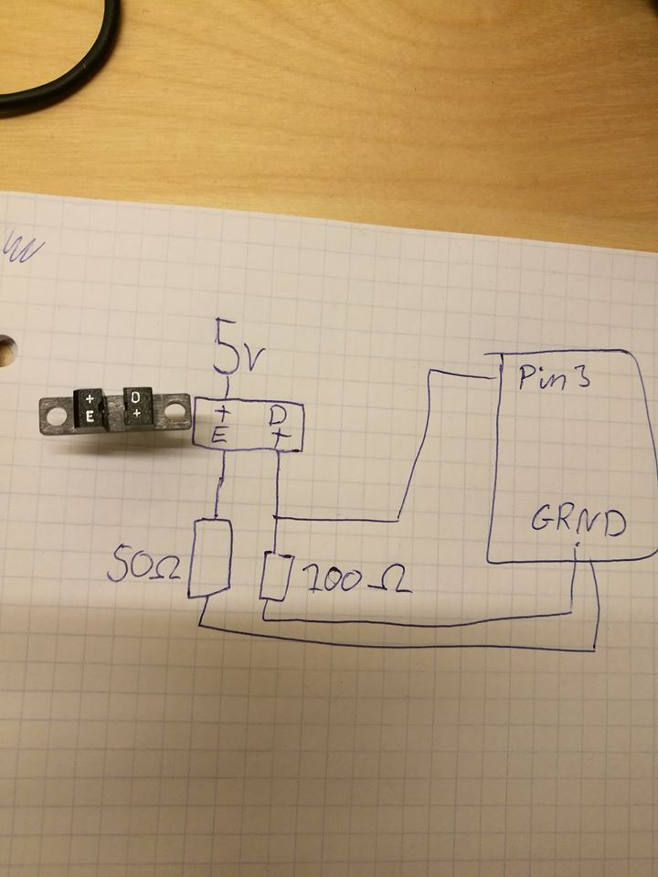

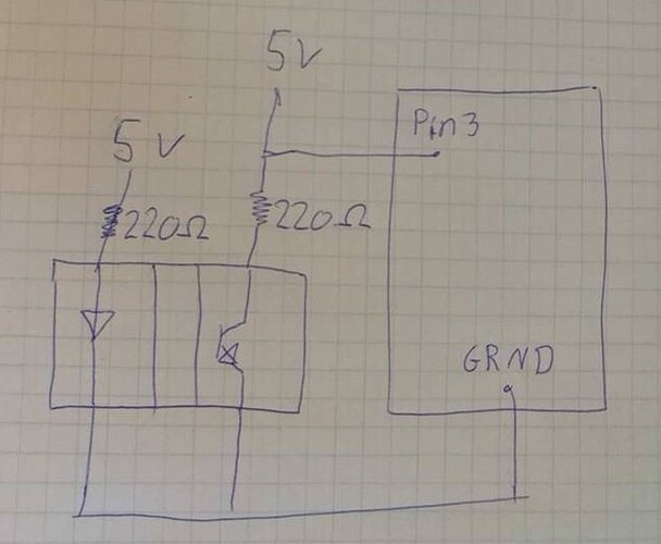

I already attached a pencil drawing of the circuit. And just out of curiosity, why shouldn't I use Fritzing?
220 ohms is way too low a value for a pullup. Try with 10K. Or remove the external pullup and use the internal pullup. Use pinMode(3, INPUT_PULLUP) to enable the internal pullup.

When you have a component that you are not familiar with, the first thing that you should do is take a look at its datasheet. There may seem to be a lot of complicated stuff inside, but there is usually simpler stuff that can help you - for example - example circuits for connecting the device up. The more datasheets you look at, the more you will begin to understand.
Take a look at the test circuit shown in the datasheet for the TCST2000 and you should quickly see what you are doing wrong.

Pin3 should be connected to the other side of the 220ohm resistor. The input will read HIGH when the sensor is not illuminated, and LOW, when illuminated.

Can you just check again that you have the TCST connected up correctly. I notice that the layout in the datasheet's test circuit does not match the physical layout of the device as shown on the first page. The physical layout does not match your hand drawn schematic either.
Can you document how you have the four pins coming out of the bottom of the unit are connected. I can see in the data sheet that the terminal arrangement may be confusing.
As mentioned the sensor side resistor is far too small. Try 10k or larger, and connect the right point to pin3, the junction of
the phototransistor and the pull-up.
An optical sensor like this will have very low gain as it has a lossy optical path. So 20mA in the LED
might only lead to a fraction of a mA through the photo transistor.
You may also have to worry about ambient light getting in.
This is how I set it up. I assume I did it correct, but I'm a beginner.
That doesn't look right. You need to connect the + pin to 5v like you did with the LED side, and the D pin to the resistor/pin3. And take the other's advice about increasing the resistor; start with the 10k.
While you are at it, that 50 Ohm resistor for the LED is sailing far too close to the wind at 5v supply; 68 Ohm would be a safer choice.

The first wiring arrangement is wrong. The connection to pin 3 should come from the other side of the resistor (i.e between the resistor and the photo diode) and, as someone else has said it should be a 10k resistor.
I can't make sense of the diagram in Reply #13
