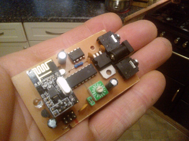

I have made 6 PCBs, which I will configure as one transmitter and five receivers, I have a selection of bare-bones-nrf boards and some with the SMA antenna to test

Current PCB, standard mount, with plans to go to surface mount in the near future :slight_smile:

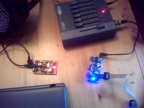

Video of my project working using latest prototype PCBs and new "autoPairing" software
I have the code ready to publish if anyone is interested

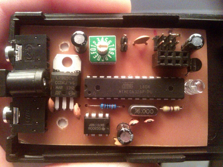

I'm trying to reverse your board in my head, what's the little 8-pin DIP? is that a 485 or something like that? And then a 328P in the middle, at 16Mhz? and then what kind of connectors are on the side of the board, I see a power connector and then 2 other jacks?
Thanks!
Jimmy
I have attached a pic Jimmy,
The connectors at the top are two 'headphone' type connectors that I use for daisy chaining DMX in/out (I have small jack-to-xlr leads on my projects, its keeps the huge XLR sockets off the board !!)
between these is a standard 12v power socket
The 8 pin dip is indeed a Sn76175 rs485 interface chip, ATMeag328 @ 16mhz, bi-colour LED on 470R, SPI programming connector next to nRF24 socket, single jumper above the SPI is to control if the board is RX or TX, and the HEX switch is there for fixed channel selection

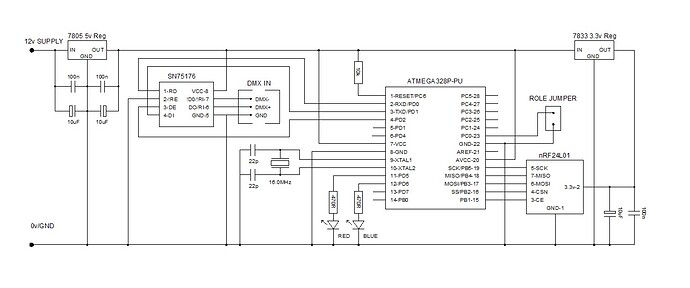

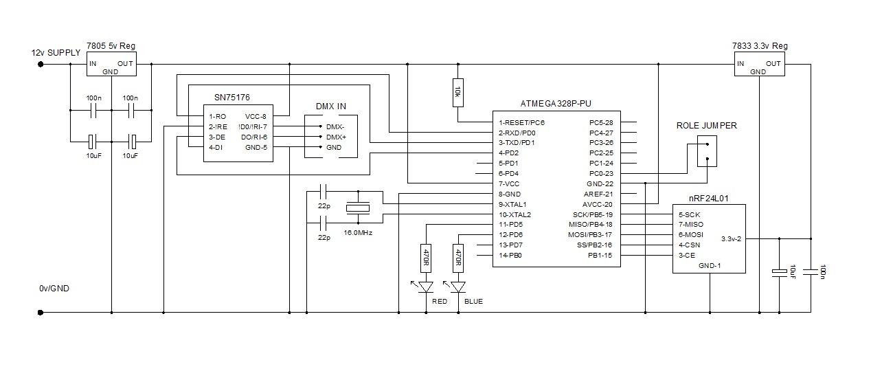

Schematic for the above code...
I will try this setup as a baseline. I've had trouble getting everything working with too many features! Thanks for this!
There is a mistake i noticed on the schematic (or software)
PIN 3 of the SN75176 should go to DigitalPin 3 (PD3 - actual pin 5) of the micro
OR you could change
"#define DMX_MODE 3" to read "#define DMX_MODE 2"
My bad :slight_smile:
