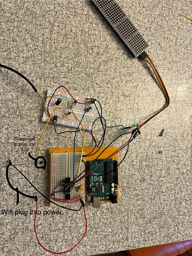

I am currently working on transporting my 32-Band Audio Spectrum Visualizer Analyzer that I made from this website: 32-Band Audio Spectrum Visualizer Analyzer | Arduino Project Hub to an ATmega328-pu. However, I ran into an issue of not having enough pins. After watching this video: https://www.youtube.com/watch?v=Sww1mek5rHU and making the basic circuit for the ATMEGA328-PU I realized that I need another ground pin and a 3.3v and 5v pin on the ATmega328-pu to wire up my project to the ATmega328-pu. What should I do?

There is no 3v3 pin on ATmega328-pu, you have to add voltage converter from 5v power supply. It is exactly how it done on Nano in the original project.

There are you saying I don't need to plug it in to any pin on the ATmega328? Just an external source?
To plug what? 3v3 pin?
You must not to plug 3v3 to atmega328, if you use 5v to power the MCU.

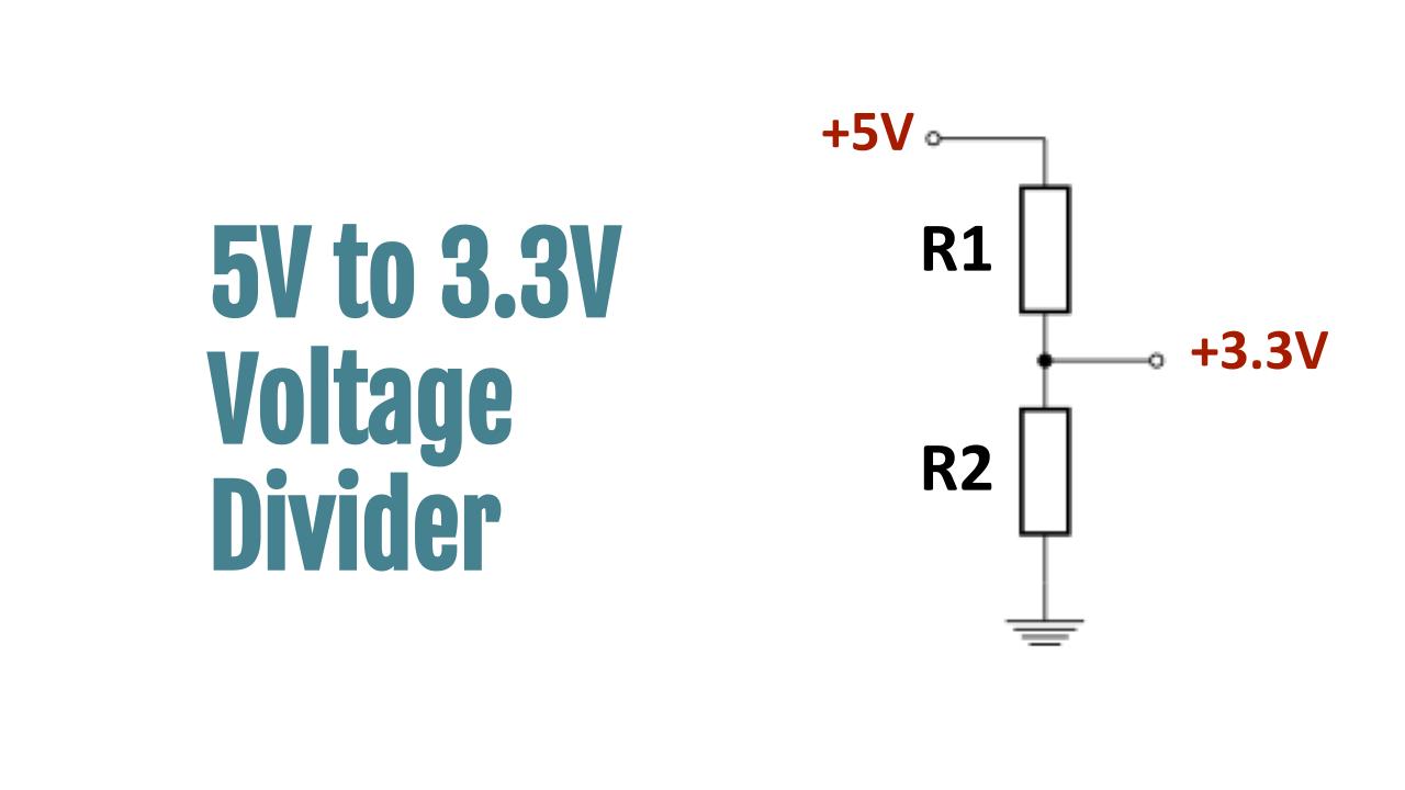

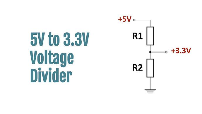

Sorry, I am pretty new. Can I just put a resistor between the power to make 3.3v?
Yes, you can use a 5v to 3v3 voltage divider
Is this right or wrong?
Your diagram looks incorrect. The main idea of original connection is adjust analog reference voltage, but on yours AREF pin doesn't connect
