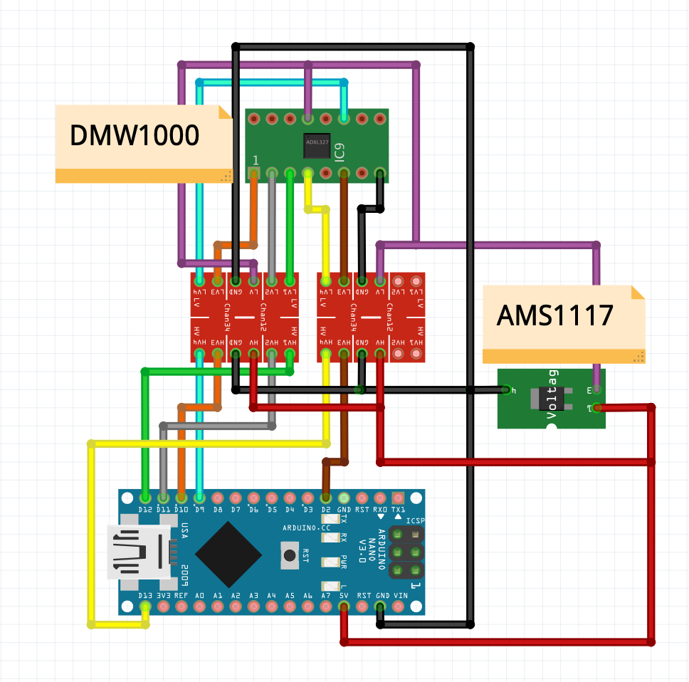

Hello. I am new to arduino, so I don't know much about pins. I found this tutorial that explains how to do what I want with an arduino UNO: Interfacing DWM1000 Positioning Module with Arduino
My problem is that I use an arduino Nano and I don't know if everything will work the same (I don't want to burn anything due to some bad connection).

  1. The tutorial says that 5V should be used, what should I do? I think the nano only offers 3V on the output of the "VIN" pin.
  2. The tutorial says that pin 13 should be used, but the arduino nano doesn't have pin 13, so I changed it to pin 8... and the pin that the tutorial says should go to 2 I put it on pin 7. Will those work well?
  3. The tutorial says that I should use "AMS1117 3.3V DC Power Supply Module". I bought this: Amazon.com
    (It has the same model, but it is different). What connections should I make? Since that only has 3 pins and the one in the tutorial has 4 (although the tutorial only has 3, it confuses me).
Is this to do with this?
What do you think the 5V pin on the Nano is for?
Vin is an input for power and it does not offer any output voltage/power.

Here I finished the diagram:
I'm going to ask a few questions just to double-check that everything is okay. I hope not to bother:

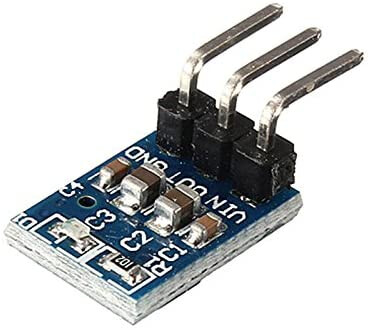

1- Regarding the AMS1117 module that I bought by amazon.
https://www.amazon.com/dp/B01HXU1NQY
It has 3 pins, VIN (red), OUT (purple), GND (black). Are my connections correct?
2- I put the connections on the exact pins that the tutorial says: 13, 12, 11, 10, 9, 2. Will everything work fine? (I ask because I use Nano and the tutorial is ONE).
3- I'm really going to appreciate being told if I have a mistake.
It looks fine, have you got a DMM?
Make sure the gnd of the Nano and the gnd of the regulator and the gnd of the level adapter are all connected together.
