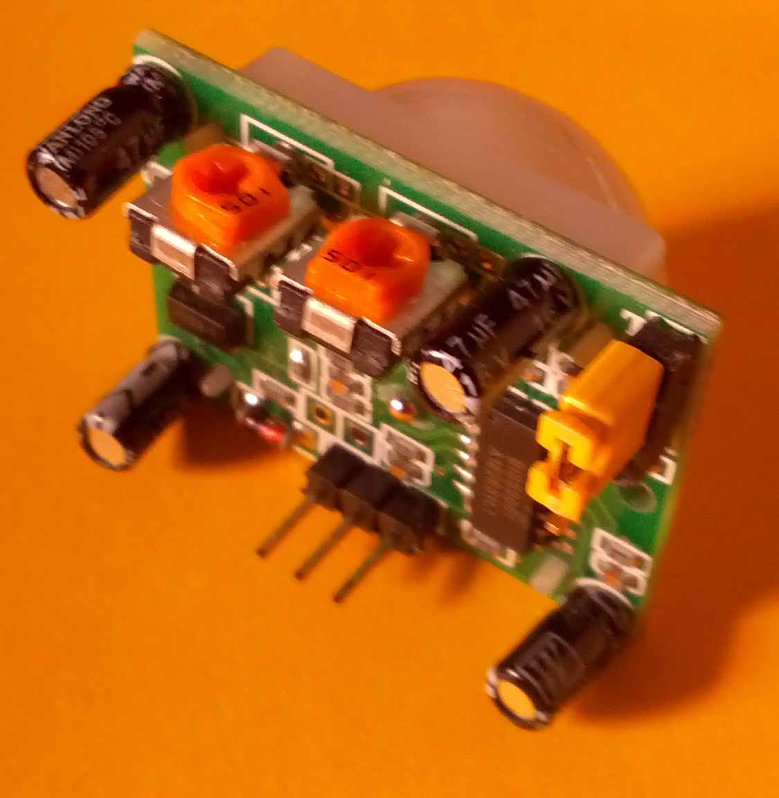

Hi, I'm fairly new here. I made a project with a 4-relay shield, operating 3 DC motors and I got that working. I even worked out how to run the program only once. I did this because I want to make it run once (or max 4 times) when a Passive Infra Red sensor with timer has been triggered.
When someone passes by, butterflies will flutter about..
How can I connect the 3 pins of the PIR/Timer to my board and/or shield (which pins for Vcc,Gnd and Signal 5V?) and how do I add the sensor into the code?

A data sheet for the sensor would be more useful than a picture. You do not say which Arduino board that you are using (is it a 5V or 3.3V board?). Please read the how to use the forum stickies. They will explain how to properly format and post code and provide hints on what we need to know to be able to help you.
The Board is Arduino Uno
The shield DFRobot 4-relay
The Sensor HC-SR501 (see attachment)

Here is a simple sketch using your code to try the sensor. Connect the sensor output to pin 3. You may need to put a delay in setup() to wait for the sensor to initialize. The sensor can output false pulses during its initialization (see data sheet).

Dear groundFungus, just tried and it worx!
I can now adjust times, intervals etc and mount this whole part on the panel.
Thanx a BIG lot!!
