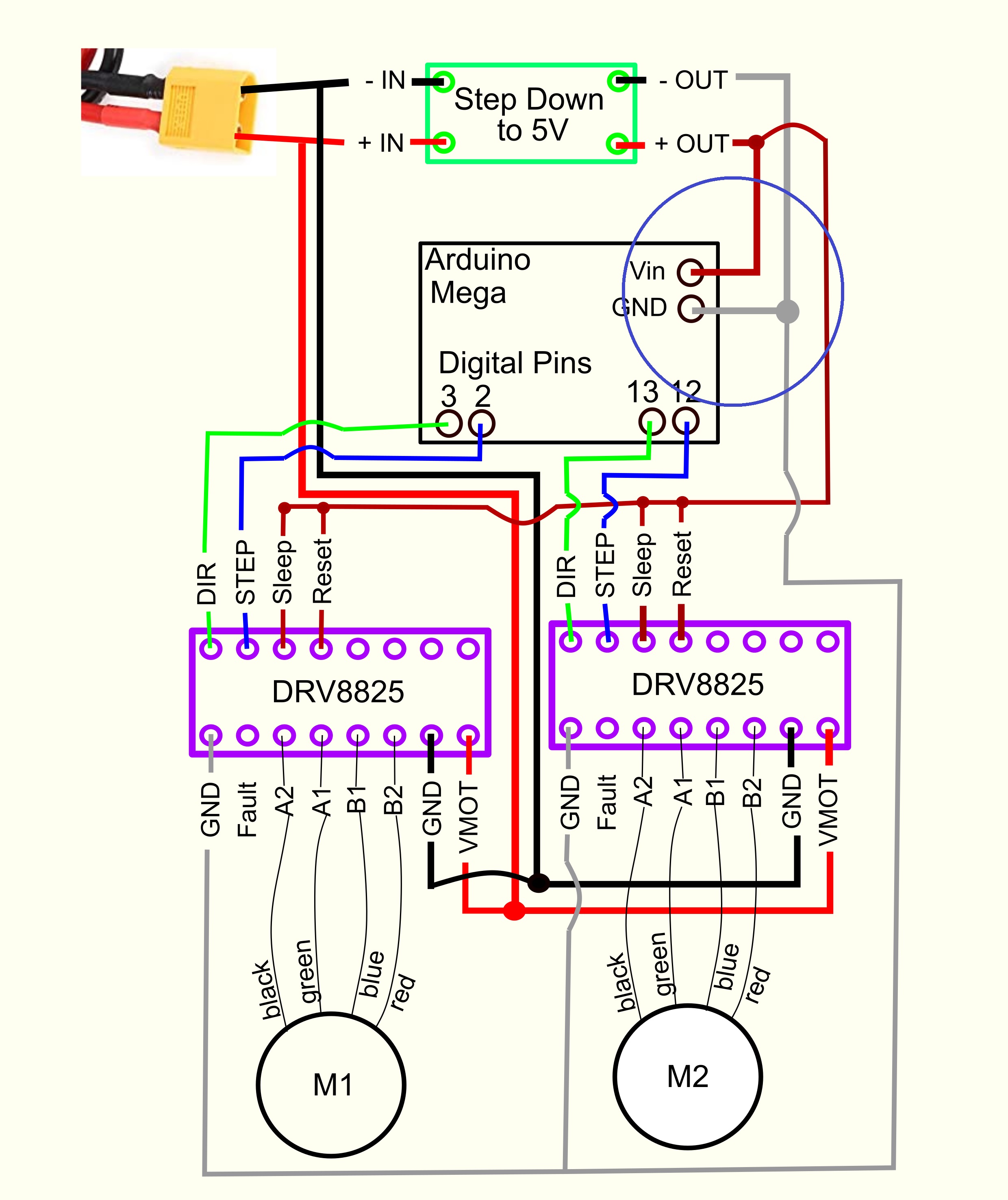

Trouble controlling two stepper motors at the same time
Additional things I tried in the meanwhile:
  • replaced all wires
  • replaced the DRV8825's with new ones
  • double, triple checked the wiring
  • tried different connections of voltage supply for arduino and the DRV's
  • checked all digital pins of the arduino using different sensors and dc motors
Nothing fixed the problem.
Only thing I haven't replaced right now is the arduino itself. But I will leave it for now. Don't want to buy a new one right now.
Thanks for all of your help guys!
You have 5V from the converter connected to Vin, it should be connected to the 5V pin.
Vin requires 7V or more to provide a stable regulated 5V to the controller.
Thanks.. Tom.. :slight_smile:
TomGeorge:
Well spotted.
However I believe the OP has also tried powering the 5v side from the USB connector without using the converter.
