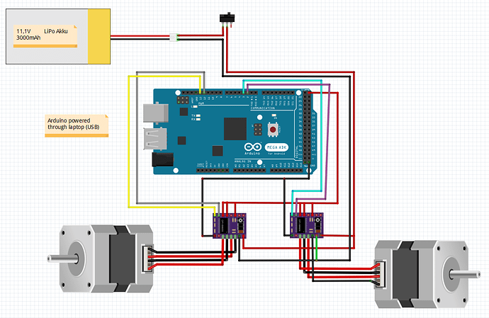

Here's my problem:
If i just run one motor everything works fine BUT the other motor and other driver board have to be fully disconnected!.
As soon as I connect the second motor (don't run it, just connecting the driver to the arduino and power supply and the motor to the driver) the first motor stops working.
To sum it up driving one motor works, but when connecting the second with the exact same wiring, motor 1 stops working (code stays the same).
What I did already:
  • I already checked the voltage at the driver board
  • Also checked all the wires
  • Switched the driver boards
  • Checked and switched all pins
  • Tried a Step Down Converter to 5DC to connect the driver boards to the battery instead of using Arduino 5V pins
  • tried different codes
  • decreased and increased the current using the potentiometer

@highfish1, please make a simple pencil drawing showing how you have everything connected and post a photo of the drawing.
It is too easy to misunderstand Fritzing diagrams and, also, it is impossible to read the pin labels.

@Robin2
I just drawed the two scenarios. For both scenarios I use the same code:
#define dirPin 3                              //using Motor1
#define stepPin 2                            //using Motor1
#define stepsPerRevolution 200
  // Declare pins as output:
  pinMode(stepPin, OUTPUT);
  pinMode(dirPin, OUTPUT);
  // Set the spinning direction clockwise:
  digitalWrite(dirPin, HIGH);
  // Spin the stepper motor 1 revolution slowly:
  for (int i = 0; i < stepsPerRevolution; i++) {
    digitalWrite(stepPin, HIGH);
    delayMicroseconds(2000);
    digitalWrite(stepPin, LOW);
Scenario One: Motor 1 does work
Scenario Two: Motor 1 doesn't work
Now I want to figure out why Motor 1 stops working as soon as I connect the second motor. Even if I do not programming any actions for the motor 2.
If I got that going I want to add the second motor to the code. (Doing that later)
(MOD EDIT)
Thank's for the much clearer diagrams.
I confess I can't see anything wrong except that you don't have 100 microfarad capacitors across Vmot and GND at the DRV8825s. See the diagram on the Pololu DRV8825 web page.
Do you have the same problem if you switch the code to drive the other DRV8825?
I presume you have tested both motors and drivers separately.
What happens if you disconnect the 5v step down and just power the Mega using the USB cable?
