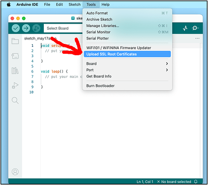

On macOS, you should have a "menu bar" at the top of the screen when you have an Arduino IDE 2.x window open. That menu bar should contain a "Tools" menu, which in turn contains the "Upload SSL Root Certificates" menu item:
Yes, I do see that in IDE 2 and previous versions. I think my problem is that I am using the Arduino IOT cloud "WebEditor" where I can't find these tools except in obscure locations such as the WiFi firmware updater where those things are done in the cloud I guess.
The Webeditor is my problem I believe. I think the accurate question will be where to upload SSL certs in the Arduino Web Editor. Thanks for your help. Jeff
