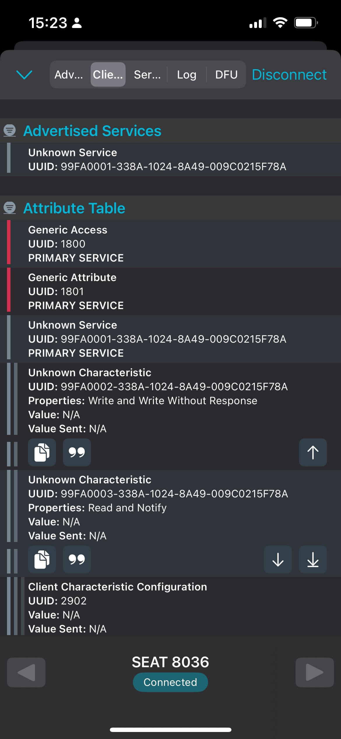

Hi i'm having trouble sending hex data trough ble, hope someone can help me. So I want to send a byte array of uint16_t = 0x0b00, I devided it in 2 seperate uint8_t veriables and tried sending it with the big endian and little endian way (both don't work). My code will be below, with this code I'm succesfully able to connect and to change the name of the extern ble device but not send the byte array. I tried this code by connecting the nano 33 ble to another nano 33 ble and it works fine while sending to another arduino but not the extern device. When I send the hex commands to the other nano 33 ble I'm perfectly able to receive them. Also when I send the hex commands trough my phone with the nRF connect app I'm able to send the commands to the extern device with the characteristic 99fa0002-338a-1024-8a49-009c0215f78a, (see screen shots below) so what does my phone do that the arduino doesn't?

As you can see, I wrote a lot of debug commands in my code so I will show you my serial monitor:
starting scan
Found peripheral
Connected to peripheral
Attributes discovered
SEAT 8036
Name writable
Name changed
Value writable
Value not written
RSSI: -59
Value writable
Value not written
RSSI: -60
Value writable
Value not written
RSSI: -60
As we can tell by the debug commands, the function .writeValue doensn't work when I'm connected to the extern device. To understand why it doesn't work I checked the arduino ble librarie, this is the github link: https://github.com/arduino-libraries/ArduinoBLE/tree/master
