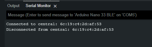

When I connect with my MIT app I can see in the Serial Monitor that I'm connecting and disconnecting.
On my app I am getting the Service GUID and Characteristics from the Nano
Only thing that's missing is my data being sent to the Nano :weary:
Serial.PrintLn displays nothing at all when I use my app but displays the value I sent using the LightBlue

If I send Binary 4 / 100 in LightBlue it will work anyway and the Serial Monitor displays "4"
The MIT app is READing very happily. But it fails to WRITE successfully. Is there some other flag that I need to set after connection?!
BytesWritten on the MIT app side confirms that everything is sent correctly.. but the SerialMonitor side nothing happens.
