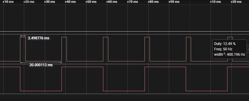

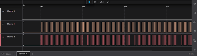

I did not create a library for this, but, did a quick and dirty sketch which should sweep a servo on pin 5 from 500-2500us in about 2 seconds and then back in another 2 seconds:
#include <UNOR4_digitalWriteFast.h>
#include <pwm.h>
PwmOut pwm5(5);
  Serial.print("Quick and dirty PWM Servo Test");
  pwm5.begin(1000000 / 50, 1500, false);
  pinMode(6, OUTPUT);
  FspTimer *ptimer = pwm5.get_timer();
  // lets play with a logical sweep where it takes something like 2 seconds to go 500-2500 and likewise back
  for (uint32_t pw = 500; pw <= 2500; pw += 40) {
    pwm5.pulseWidth_us(pw);
    digitalToggleFast(6);
    delay(20);  // 2000 increments
  delay(100);
  for (uint32_t pw = 2500; pw >= 500; pw -= 40) {
  delay(100);
I have it updating every 20ms as most servos are setup for 50hz PWM signals... Some can go faster. I toggle a pin each time I change the pulse width, using my own digitalToggleFast.
Would be simple to convert to digitalWrite... but ...
It looks like it is working some:
At one end of a sweep:
The other end:
