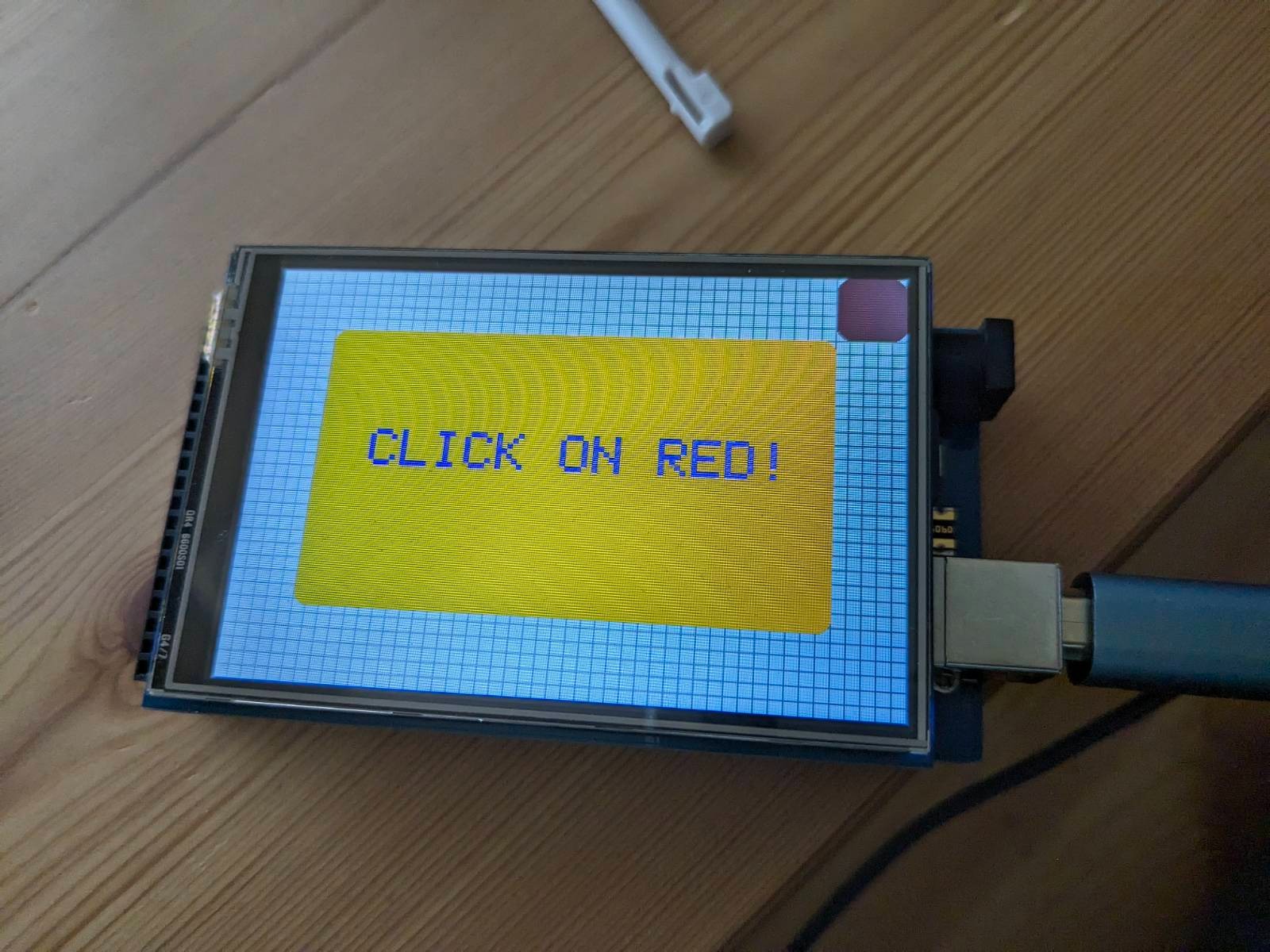

The next step was to get the touch function to work. I'Ve tried various approaches without any luck until I found a calibration sketch in the examples of the MCUFRIEND_kbv library. I've included parts of that sketch into my demo project and got the touch functionality to run for the whole screen as one big responsive zone.
Here start the problems
After defining the whole screen as touch zone I tried to narrow the zone down with another code snippet I found.
bool touchedWithin(TSPoint touch, unsigned x, unsigned y, unsigned w, unsigned h)
  return (touch.x > x) && (touch.x < (w)) && (touch.y > y) && (touch.y < (h));
  if(touchedWithin(p, 0, 0, 250, 250))
    {Serial.println("Touch!");}
This works on an area in the upper right corner of the screen (more or less the red area). But I have no idea how the width and height of this area correlates with the size of the screen. Any value under roughly 200 in both w and h attributes doesn't produce any touchable area. Values around 250 create an area at the size of the red area. But if i make the button bigger, It goes haywire. I've tried to double and triple it in size from 50/50 to 100/100 and 150/150 with the correlating dimensions of the touchedWithin call to 250/250, 500/500 and 750/750. With those larger values the responding zone covers the whole screen again. My goal would be to create clickable buttons that are limited to the area their drawn counterparts show. Also, the "working" touch event with 0,0,250,250 creates a lot of responses in the monitor, not just a single "I've been clicked". As I want to control a motor shield later on, that shouldn't be a dozen or more responses... What am I missing, what am I doing wrong?
grafik
I'm using an original Arduino Mega 2560 R3 with a 3.5" TFT Display 480x320. The product page on Amazon even says the display is compatible with UTFT / UTFT_Buttons / Utouch Library, but all I get is a blank white screen when using those libraries. It seems I'm not the only ohne with this problem: shields - 3.5" TFT LCD Display is not working with Arduino Mega 2560 R3 - Arduino Stack Exchange
But the modified UTFT library didn't work either. I'd prefer UTFT over MCUFRIEND because the guide I'm following uses those libraries too.
Here's my current sketch with MCUFRIEND/Adafruit GFX:

Rather than just shotgunning numbers, try using the calibration routine to determine specific locations then write routines that box each of those areas and include code for the desired response when that area is touched.
I've had good luck with MCUFRIEND.kbv. None with Adafruit.
I got this output from the TouchScreen_Calibr_native sketch from MCUFRIEND.kbv. In fact, that sketch is where I "borrowed" my touch setup from.
But frankly speaking, I've got no idea what to do with this information - how does that help me with determining some sort of grid I can work with?
Does that mean the Portrait coordinate system looks something like this?
927/0 ------------------191/0
0/198---- -------------------191/198
Do you see any chance that I get UTFT running with that display?
cx=551 cy=214 cz=622  X, Y, Pressure
cx=217 cy=950 cz=261  X, Y, Pressure
cx=216 cy=580 cz=442  X, Y, Pressure
cx=211 cy=216 cz=602  X, Y, Pressure

EDIT: I found this thread, where the OP used the calibration Data in the initialization of his screen and also uses Pressure readings. So maybe parts of his code will solve my problems. I'll try to implement those parts and reply after testing. Thanks so far.
Basically, the concept is to use the calibration sketch to find the coordinates of the areas you want to use for buttons, not just the layout of the whole screen.
And, although he does not show the code, it is obviously possible to do what you are looking for:
HTH
Thanks a lot! I'll dig in and have a look at it. I'll report back after a lot of reading and testing :wink:

/* define pins for resistive touchscreen - these are used in most examples:
#define YP A2  // must be an analog pin, use "An" notation!
#define XM A3  // must be an analog pin, use "An" notation!
#define YM 8   // can be a digital pin
#define XP 9   // can be a digital pin
They didn'T work for me this way. Refer to the MCUFRIEND Calibration Sketch for details:
TouchScreen_Calibr_native.ino in libraries\MCUFRIEND_kbv\examples\TouchScreen_Calibr_native
This was my reading:
cx=558 cy=215 cz=609  X, Y, Pressure
cx=223 cy=951 cz=269  X, Y, Pressure
cx=217 cy=585 cz=435  X, Y, Pressure
cx=212 cy=217 cz=606  X, Y, Pressure
*** COPY-PASTE from Serial Terminal:
const int XP=6,XM=A2,YP=A1,YM=7; //320x480 ID=0x9486
const int TS_LEFT=932,TS_RT=193,TS_TOP=968,TS_BOT=198;
PORTRAIT  CALIBRATION     320 x 480
x = map(p.x, LEFT=932, RT=193, 0, 320)
y = map(p.y, TOP=968, BOT=198, 0, 480)
LANDSCAPE CALIBRATION     480 x 320
x = map(p.y, LEFT=968, RT=198, 0, 480)
y = map(p.x, TOP=193, BOT=932, 0, 320)
#define YP A1 // must be an analog pin, use "an" notation!
#define XM A2 // must be an analog pin, use "an" notation!
#define YM 7 // can be a digital pin
#define XP 6 // can be a digital pin
// Define touchscreen parameters
// Use test sketch to refine if necessary
#define TS_MINX 970
#define TS_MAXX 190
#define TS_MINY 190
#define TS_MAXY 930
#define STATUS_X 10
#define STATUS_Y 65
// define touchscreen pressure points
#define MINPRESSURE 10
#define MAXPRESSURE 1000
// Define button array object
Adafruit_GFX_Button buttons[2];
// Define object for TFT (LCD)display
MCUFRIEND_kbv tft;
// Define object for touchscreen
// Last parameter is X-Y resistance, measure or use 300 if unsure
TouchScreen ts = TouchScreen(XP, YP, XM, YM, 300);
Serial.begin(9600); // Start Up the Serial Monitor
  Serial.println(("TFT LCD test")); //Say Hello in Serial Monitor
  tft.reset(); // Reset the Screen
  uint16_t identifier = tft.readID(); // Identify the Screen - in my case it is 0x9486
  if (identifier == 0x9325) {
    Serial.println(F("Found ILI9325 LCD driver"));
  } else if (identifier == 0x9328) {
    Serial.println(F("Found ILI9328 LCD driver"));
  } else if (identifier == 0x4535) {
    Serial.println(F("Found LGDP4535 LCD driver"));
  } else if (identifier == 0x7575) {
    Serial.println(F("Found HX8347G LCD driver"));
  } else if (identifier == 0x9341) {
    Serial.println(F("*Found ILI9341 LCD driver"));
  } else if (identifier == 0x7783) {
    Serial.println(F("Found ST7781 LCD driver"));
  } else if (identifier == 0x8230) {
    Serial.println(F("Found UC8230 LCD driver"));
  else if (identifier == 0x8357) {
    Serial.println(F("Found HX8357D LCD driver"));
  } else if (identifier == 0x0101)
    identifier = 0x9341;
    Serial.println(F("Found 0x9341 LCD driver"));
  } else if (identifier == 0x9481)
    Serial.println(F("Found 0x9481 LCD driver"));
  else if (identifier == 0x9486)
    Serial.println(F("Found 0x9486 LCD driver"));
  else {
    Serial.print(F("Unknown LCD driver chip: "));
    Serial.println(identifier, HEX);
    identifier = 0x9486;
  // Setup the Display
  tft.begin(identifier);
// read in the screen size - As we rotate the display to landscape mode after this step, the "width" would be the shorter side (from USB Port to Power Port), so I'll flip them here.
  uint16_t screenHeight = tft.width();
  uint16_t screenWidth = tft.height();
  tft.setRotation(1); // The rotation parameter can be 0, 1, 2 or 3. For displays that are part of an Arduino shield, rotation value 0 sets the display to a portrait (tall) mode, with the USB jack at the top right. Rotation value 2 is also a portrait mode, with the USB jack at the bottom left. Rotation 1 is landscape (wide) mode, with the USB jack at the bottom right, while rotation 3 is also landscape, but with the USB jack at the top left.
// Output screen size to Serial Monitor
  Serial.print("TFT size is ");Serial.print(screenWidth);Serial.print("x");Serial.print(screenHeight);
// FILL THE SCREEN WITH BLACK AND DRAW UI
  tft.fillScreen(BLACK);
  // Draw a vertial grid
for(int drawHelper = 0;drawHelper<screenWidth; drawHelper+=10){
tft.drawLine(drawHelper, 0, drawHelper, screenHeight, DARKGREY);
//horizontal grid
for(int drawHelper = 0;drawHelper<screenHeight;drawHelper+=10){
tft.drawLine(0, drawHelper, screenWidth, drawHelper, WHITE);
// Define Values for Buttons and draw them
      buttons[0].initButton(&tft, 240,75, 380, 100, WHITE, YELLOW, BLUE, "BUTTON 1", 4);
      buttons[0].drawButton();
      buttons[1].initButton(&tft, 240,200, 380, 100, WHITE, MAROON, WHITE, "BUTTON 2", 4);
      buttons[1].drawButton();
// Draw a Status Bar
tft.fillRect(0, screenHeight-50, screenWidth, 50, LIGHTGREY);
//touchscreen
  digitalWrite(13, HIGH); // We start by triggering the touchscreen, which is done by toggling pin 13 on the Arduino high. If something is touching the screen we read it and assign it to a TSPoint object named “p”.
  TSPoint p = ts.getPoint();
  digitalWrite(13, LOW);
  pinMode(XM, OUTPUT); // We then need to reset the pin modes for two of the touchscreen pins back to outputs. This is done as these pins get shared with other LCD display functions and get set as inputs temporarily.
  pinMode(YP, OUTPUT);
  if (p.z > MINPRESSURE && p.z < MAXPRESSURE)
  { // Now we check to see if the pressure on the screen was within the minimum and maximum pressure thresholds we defined earlier.  If it makes the grade then we determine where exactly the screen was pressed.
  p.x = p.x + p.y;
    p.y = p.x - p.y;
    p.x = p.x - p.y;
    p.x = map(p.x, TS_MINX, TS_MAXX, tft.width(), 0);
    p.y = tft.height() - (map(p.y, TS_MINY, TS_MAXY, tft.height(), 0));
    statusbar("SCREEN",p.x,p.y);
   // Go thru all the buttons, checking if they were pressed
  for (uint8_t b = 0; b < 2; b++)
        if (buttons[b].contains( p.x, p.y ) )   // (-1, -1) will always fail
            buttons[b].press( true );
        if ( buttons[b].justPressed() )
              //Tell if Button has been pressed
            if (b == 0)
              statusbar("BUTTON 1",p.x,p.y);
            if (b == 1)
              statusbar("BUTTON 2",p.x,p.y);
            buttons[b].press( false );
void statusbar(String buttonname, uint16_t x, uint16_t y){
tft.fillRect(0, tft.height()-50, tft.width(), 50, LIGHTGREY);
tft.setCursor(50,tft.height()-35);
tft.setTextSize(2);
tft.setTextColor(BLACK);
tft.print(buttonname);tft.print(" touched at X=");tft.print(x);tft.print("/Y=");tft.print(y);tft.print("\r\n");
Serial.print(buttonname);Serial.print(" touched at X=");Serial.print(x);Serial.print(" Y=");Serial.print(y);Serial.print("\r\n");
